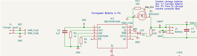

"We are having some trouble setting up BQ24040. The IC is not regulating properly.
I changed values from Riset and I got different Vout results but none of them seem to be correct.
I tried:
Riset= 1k and Vout is 4,5V
Riset= 8k2 and Vout is 2,6V
"As far as I understand this value should only affect the current provided and Vout should remain always 4.2V, shouldn't it?"
We're we want to charge a Lipo battery through a wireless charger. The input is 5V and this one is capable to charge at 5W. We tried the same result with a couple of lipo batteries, one at 3.7V and the other one at 3.9V.
We tried the same input and the same output with another charger circuit and it worked. That's why we don't know what might be happening in this new circuit, which is almost the same as the other.
Here I attach the schematic. There's no Q2 neither R13 and Q2.2 and Q2.3 are now shorted."

  • Hi Marvin,
    How is the customer measure Vout? This is a battery charger, when no battery is connected at OUT, the device will be in battery detection mode where the output is going to be a square waveform. Please see datasheet page 20, section 8.4.12 for details. In short, the VOUT is not always 4.2V.
    Can you please clarify the test condition? Does the customer mean that the battery gets charged to 4.5V and 2.6V?
