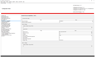

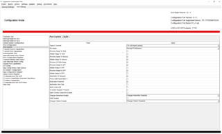

We take adjustments using the application customization tool and set the following:
Port Control (0x29):
Transmit Source Capabilities (0x32):
The result should have been, that the current on the USB-C-Recaptacle should not got over 2A, but with these settings the sourcing current on the receptacle goes all the way to 3A.

  • Hi Raisa,
    Do you have a PD analyzer to confirm you are negotiating the 5V/2A PD Contract? We recommend using the Total Phase PD Analyzer as a low cost option.
    Likely what is happening here is that you are not entering a PD contract and instead are stuck in a 5V/3A standard USB-C mode of operation. I would recommend adjusting your Port Control (0x29) setting: Adjust the "Type-C Current" setting from 3A to 1.5A.
    Please note that in order to negotiate a USB-PD contract with your settings in the Source Capabilities register (0x33), you would need to have a USB-PD capable device connected to the other end of the cable. If not, you would enter a standard USB Type-C mode.
