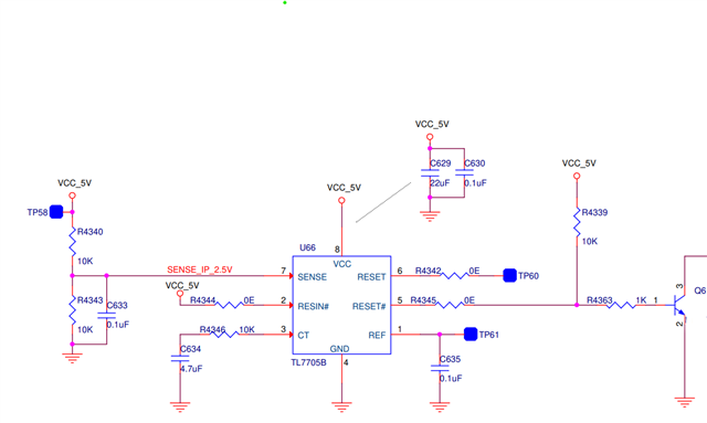

Hi Sir,
We are using TL7705B in our design.
While testing we observed the chipset is not releasing from reset.
I am providing exactly 5V at VCC Pin, The voltage at REF (Pin 1) is exactly 2.5V
The voltage at CT pin is also discharged to 0.6V.
I am attaching the schematics please go through it.
I have not provided the pull down resistor of 10K for RESET Pin in schematics. While testing manually i have soldered 10K pull down resistor at RESET pin 6. Even then also i didn't find any improvement. The IC is not releasing from RESET (RESET# pin is always high)
i have even tuned the capacitor C634 to 0.1uF & R4346 to 0 ohm. But still same response.
