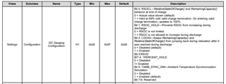

  • Hi Wyatt,
    while working my way through the bq27Z561-R2 TRM I noticed what looks like a couple of errors. On page #30 of the TRM it shows the default value for Settings.Configuration.I2C Gauging Configuration as 0x08 (bit 3 hi). However, bit 3 is shown reserved in the TRM. BqStudio shows a value of 0x08 as the value and the bit is labelled TAMB_SYNC_SIM. So, the text in the TRM right-hand column appears wrong. Also, in bqStudio, bit 4 is shown reserved, in the TRM it is1PERCENT_HOLD.
    Sid
  • Hello Sid,
    I would double check and make sure you're using the correct BQZ file since with each revision of the firmware new features are added.
    I checked the TRM and compared to the BQZ and don't see the differences you describe with the registers.

  • Was able to update firmware to R2.
    The TRM is still incorrect. The default for Settings.Configuration.I2C Gauging Configuration in the TRM says 0x08, it is in fact 0x20. Bit 3 (0x08) is a reserved bit.
    Sid
  • Hello Sid,
    Yes it does look like there is a discrepancy between the TRM and BQZ for the default value. The default in the BQZ should be the correct reference to use.
    Sincerely,

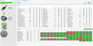

    My next question is more specific, I am currently getting the gauge through some learning cycles with the LTO cell we have. LTOs are lower voltages that LiPo and I am using the CHEMID TI produced for us from cell samples. The Discharge and Relax phases are working correctly with the various status bits going to the correct states. However, when going through the charge phase the gauge is not detecting Valid Charge Terminate (VCT). The FC and TC bits are set correctly but not VCT.
    Looking at the registers in bqStudio I see the Charging Voltage (read only) is 4400mV, this is a LiPo value, I think. Plus, the charging current shown in the registers is wildly incorrect. This is odd because the Voltage and Current registers are correct.
    I have read the TRM but failed to find where the Charging Voltage and Current are updated from. Pointers would be most welcome.
    Sid
  • Hi Sid,
    There are a variety of conditions that must be satisfied in order for VCT to be true. Please see below:
    I would start by looking at a log file of your chg-relax-dsg-relax cycles to ensure that the VCT conditions are being met. I would pay special attention to taper current as this is typically a ratio of charging current. If the charging current value is off for some reason, I suspect this could be the cause. That being said, you should be able to change the value of taper current manually and set it to a value that works such that you hit VCT.
    Hope this is helpful,

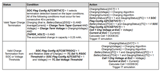

  • Thanks I have already checked that the taper current is set correctly, and I have monitored it the charge cycle.
    The reason I asked about the "Charging Voltage" is because the TRM is vague as to which voltages are addressed in this formula:
    Voltage() + Charge Term Voltage ≥ ChargingVoltage()
    I assume that "Voltage" is the cell voltage, this is about 3000mV on charge termination. "Charge Term Voltage" is set in the Data Flash to be 3000mV.
    What is "Charging Voltage" and where is it from, being read only in the Data Flash.
    Please see my comment in my previous post about "Charging Voltage." To the best of my knowledge this is what is causing VCT to not be asserted.
    Sid
  • Hello Sid,
    The Voltage is the reported SBS register for the battery voltage, which yes should be the cell voltage.
    The ChargingVoltage() is part of the advanced charge algorithm settings, you should set it up to align with your systems charging voltage and current requirements at different temperatures. You can set all the ranges in data flash to align with your LTO battery.
    The Charge Term Voltage should be set yo a value so the gauge will start looking for VCT, if you set it to 3000mV, voltage will almost always be allowed for VCT and it will essentially only look at taper current. The default of 100mV is a good starting point. The only time this would really play a role is if you have a charger which does trickle charging or other non-standard charge profile the gauge may see VCT when it shouldn't and that will cause gauging problems.
    The advanced charge algorithm is explained in the TRM, chapter 9.
    Sincerely,
    Wyatt Keller
  • This makes no sense, "Charge Term Voltage" in the default configuration of the device (for a LIPO) is set to 4400mV. You appear to be describing the "Charge Term Voltage Offset", it has a default value of 100mV. So, it appears the formula in the TRM (quoted above) is in fact incorrect. Perhaps it should be:
    Voltage() + Charge Term Voltage Offset ≥ ChargingVoltage()
    In fact, perhaps even the "ChargingVoltage" should be the "Charge Term Charging Voltage" in that formula:
    Voltage() + Charge Term Voltage Offset ≥ Charge Term Charging Voltage.
    Sid
  • Hello Sid,
    In regards to the BQ27Z561-R2 TRM, it's description is correct for VCT. The data flash value Charge Term Voltage Offset is the same value as the Charge Term Voltage described in the VCT, It is just mislabeled in the data flash table at the end of the TRM, there is no other mention of the Charge Term Voltage Offset.
    If you are not using the ChargingVoltage() and ChargingCurrent() for advanced charging, then you can use the TAPER_VOLT bit to use a preset voltage, which is the Charge Term Charging Voltage.
    Sincerely,
    Wyatt Keller
  • So, what is this in bqStudio then?
    Sid
  • So I have asserted the TAPER_VOLT bit and still VCT is not set. TC and FC are both asserted. Charge Term Charging Voltage is 2900mV, Charge Term Offset is 100mV. The battery fully charged measures 3076 mV (in bqStudio). The charge current is currently 0mA, the charger stops the charge when the charge current is about 10mA.
    I apologize for just not getting this; however, it seems to me that VCT should currently be asserted. I am obviously still missing something. Here is a screen shot of my current Registers.
    Sid

  • Hello Sid,
    You have your charge taper current set to 10mA but then you don't taper below 10mA for the 80s required for VCT. I would set your Charge Term Taper Current higher so the gauge can see the termination occur.
    Sincerely,
    Wyatt Keller

    I took a look at the 40mA taper current setting, can you share your .gg file with the configuration as well for each log you collect? It looks like in the log the gauge is staying in relax or discharge mode (BattStat register) so it will not meet the criteria for VCT. I'm not sure if the Dsg Current Threshold was changed or the delay times to switch modes was changed. You must meet all the criteria for 2 consecutive 40s periods.
    Sincerely,
    Wyatt Keller
  • Hello Sid,
    I think you may not be reaching the 0.25mAh accumulated capacity requirement, your taper is so fast that there may be very little passed charge when the gauge starts looking for VCT. The gauge is constantly looking for VCT in discharge mode, it doesn't start once one of the conditions are met. This means the 40s periods are continuously being cycled.
    From reviewing your logs it looks like the taper is so fast the gauge would have to perfectly lineup the 40s period in order to qualify the taper current and other conditions before the gauge drops below the Dsg Current Threshold and leaves discharge mode.
