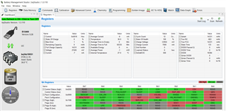

  • calibration is working perfectly fine with bqstudio and EV2400 module.
  • Now I am connecting a load of 3A to do the current calibration, this time i am having problem with calibration, bqstudio says: "calibration - Failed to enter calibration mode with command 0x2D".

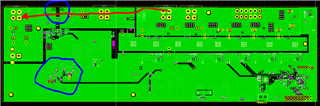

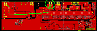

I have old version of PCB layout design that works fine even when i apply the load. So i thought i have some problem in my new PCB layout design and I am sharing this new design for your reference.
Green circled connector is where is the 3A load is applied and the green doodled line represents the power flow path.
Blue circled areas have sense resistor and BQ34Z100-G1 IC. Red doodled line represents the GND return path. Return current has to pass through a MOSFET switch and sense resistor.
Please help.
