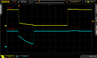

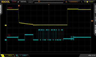

I can see the correct register writes taking place on I2C3 after the FRS event is triggered from the phone. However the role swap never completes. Below are a CSV dump of the CC line activity, as well as the voltage waveforms for VBUS, PP_HV, and CC.

VBUS in the context of CC
VBUS in the context of PP_HV (common net between the TPS65987D and BQ25792's VAC1/2/VBUS, which are all shorted on this design).
To my untrained eye, it looks like the TPS65987 switches are taking too long to close. PP_HV is ready relatively quickly - that is the BQ25792 bridge direction reverses to be a source. However 5V doesn't appear on VBUS again until over 1 second later. Looking at it closely it looks like what the eventual rising edge on VBUS corresponds to, is actually the phone reverting back to being a source. That's the only thing that explains why there's a slight sharp jump in voltage on PP_HV shortly after the rising edge on VBUS.
So the question is, why is the TPS not closing the switch shortly after the rising edge on PP_HV? It's clear the FRS even is being properly generated. Otherwise you wouldn't see PP_HV rise at all, which corresponds to the BQ25792 being told to switch into OTG mode via I2C.

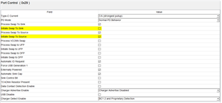

    On the Samsung, on a few tries I was able to get it to switch roles by quickly unplugging/replugging the cable after flipping the switch. However it's very hit and miss and the timing has to be quite precise. Below is a screenshot from the web of the PD role swap switch on Samsung devices.
    This is what leads me to believe the issue is with the VBUS switch closing in time for the phone to see there is a supply present before giving up. By un/replugging, I am able to force the TPS65987D back into source mode, as on an unplug event I've configured it to put the BQ25792 back into OTG mode (The system should appear as a USB host to any non-PD devices that are plugged in, so we always need Safe5V ready to go). When the cable is rapidly reconnected, the 5V source is up and the phone perceives this as a successful role-swap and is happy to resume the source/sink capabilities negotiation and subsequently pull current.
    In the OP I said "The system is intended to be a dual-role PD device with a sink role preference." To add a little more context around this, the TPS lives in a battery powered system which has USB host and device capabilities. As mentioned above it needs to appear as a host to devices like USB hubs or flash drives. This is the reason for the port to rest in the OTG/Safe5V source state when disconnected.
    When a PD-capable device is plugged in, the system should prefer the PD sink role, as the primary use case is that it is plugged into a USB PD wall charger. However it should also have the option to act as a PD source if a role-swap is requested, allowing it to be used as a small power bank.
    Hope this makes sense, and adds some clarity as to why the project file and the I2C Master events are configured the way they are.

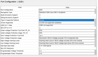

    Regardless, if we're going to offer the 'power bank' feature, it should be able to charge any connected device. i.e. We'd need to make it work with Samsung devices irrespective of compliance mismatch - it's just what an end user would expect.
    With this in mind, I tried changing configuration to Try.Src and also flipped "Initiate swap to sink" to "Initiate swap to source". This way the TPS would default to a source when connected to any sink or dual-role devices, while still be able to accept power from source only PD devices (like power bricks).
    The phone now sinks power on connection, which is good. The role swap however (somewhat expectedly) still fails similarly.
    With sink preferred, there is of course a potential issue with cases where this device is connected to either another power bank, or more importantly a USB-C + PD equipped laptop or PC. The former is more of an edge case, however the latter is a case we frequently expect as the device (in addition to being a USB host) is also configured via USB 2.0. Thus, we don't want it to try to charge the laptop when connected (hence the 'sink preferred' configuration I had in the original project). The laptop/PC should see it as sink/peripheral when connected.

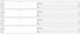

  • Unfortunately the S10 doesn't seem to advertise its sink capabilities (my understanding of the spec is that it's optional). However I did another test which yielded interesting results, so this is a fortuitous thread you've pulled on...
    Plugging the S10 into a COTS power bank or power brick, it always seems to choose the 9V PDO. However plugging it into my board (which is running the Try.Src config from 6 posts ago), it chooses the 5V PDO (as an aside, the BQ25792 seems to be regulating rather poorly in reverse under load but this is a separate discussion). This is interesting because my board offers all of the common source PDOs at 3A. You can verify this in my prj file. The S10 chooses the default (5V) PDO.
    I also tested these Source PDOs work with the Duo Sink board. Plugging it in and cycling through the 5, 9, 15, 20V buttons produces a corresponding output voltage change on my board.
    Another test I did was to plug the S10 into a Duo Source which is loaded with the demo firmware and on which I have pressed all the buttons to enable all the PDOs. With this, the S10 picks the 9V PDO as it should. So I suspect something's wrong with my project's configuration that doesn't allow the S10 to access the other PDOs I'm offering and perhaps, this also influences the role swap issue?
    To answer your other question, the S10 only offers 5V @ 500mA in its Source Capabilities advertisement.
