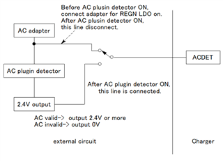

    [Background of question] We think that to use 20V adapter and 4 cell battery. If ACDET is set to about center of 20V and 4cell battery, It has risk that ACFET/RBFET might be OFF temporary by adapter voltage dropping by heavy load. Therefore, we would like to set to low ACDET threshold as possible.

    We are thinking that  input external signal 2.43V or more to ACDET directly for keeping SPEC ACDET level to between battery max and AC minimum level when even if AC adapter voltage is dropped by high load.
    Tehrefore, we would like to confirm that ACDET pin's all funtion especially functon of using ACDET pin's voltage level.

    4. When ACOC timing, if  input external signal 2.43V or more to ACDET directly during AC pluged, is it no problem?
       Or it has problem? If problem, please teach the reason.
    5. When Inductor Short, MOSFET Short Protection timing,  even though if  input external signal 2.43V or more to ACDET directly during AC pluged, ACDET will be less than 0.6V at reject plug, is it no problem?
    6. If other function uses ACDET voltage level, please teach it to me.
    7. Besides, could you teach the risk and worrying points the this external circuit if you have note, please?

    7. The external circuit may be risky. There may be a power path from battery, through BATFET body diode, through ACFET/RBFET to the adapter.

    (1) . Can ACDET connect to low directly when AC is removed? Or it is must be via resistor?
           If  ACDET connecting to GND directry is NG, please teach the recommend pull down resistor and calculation method?
    (2).ACDET pin has Sink current ? or Source current?
    Besidese, please teach the Sink current's value or Source current's value?(Max 2uA etc.) (Or internal pull down resistor or pull up resistor?)
    (3). Could you teach the risk and worrying points the this external circuit if you have note, please?
        I left reference circuit as able to as. Besides insert the diode between ADP and circuit.
    Best regards
  • 1. Yes, ACDET can be connected directly to ground.
    2. ACDET sinks current. It acts like a resistor to GND. The resistance could be anywhere from 100K to 1M, but keep in mind we don't spec this parameter.
    3. My concern would be the battery feeding back into the adapter. This might happen if the adapter voltage has a wide range to it or the adapter malfunctions.

    History of your comment (from other thread: Abuot ACOK )
    Qustion:Why should be set the voltage before it goes to ACDET threshold is greater than the maximum battery voltage when battery boost mode is not used?
    Answer:The voltage goes around the charger like you drew. This is because when Q3 switches on ACDET is exposed to the battery voltage.
  • Norimichi,
    1. Yes, the ACDET pin detects whether the voltage is above 2.4 volts. The ACDET pin goes directly to a comparator.
    2. I want to make sure I answer your question correctly. Here is how I understood your question. "If ACDET is below 2.4 volts and VCC has dropped to same voltage of the battery, ACFET/RBFET is stopped. Until VCC drops to the same voltage as the battery, the battery will discharge through BATFET's body diode. Then the battery current will discharge through the ACFET/RBFET to the AC adapter if there is not a diode between ACFET/RBFET and the AC adapter"
          Yes, that is our concern. Our concern is that the battery will discharge into the adapter in this situation.
    Ethan Galloway
  • >If ACDET is below 2.4 volts and VCC has dropped to same voltage of the battery, ACFET/RBFET is stopped.Until VCC drops to the same voltage as the >battery, the battery will discharge through BATFET's body diode. Then the battery current will discharge through the ACFET/RBFET to the AC adapter if there is not a diode between ACFET/RBFET and the AC adapter"
    I'm sorry. When VCC reaches the battery level, the ACFET is closed before the battery voltage becomes higher than the system side. Threfore, there is no reverse current from the battery to the AC side normally. It is perhaps no problem. We will reserch the detail continue.Thank you vey much.
  • Norimichi,
    Thanks for being patient with our responses.
    Yes, that is true. The three conditions to turn ACOK on act as a protection against this condition. The three conditions being VCC is withing VUVLO and VACOV, ACDET > 2.4 volts and VCC - VSRN >VSLEEP.
    Ethan Galloway
