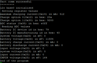

BQ25700A registers are read in below two cases .
Case 1 : By powering the IC from external battery (4S battery) without connecting external power source
Case 2 : By powering the IC from external power source (12V input with 0.5A limit) without connecting battery.
But in both cases i'm observing same output.
Please find the register values read in screen shot below. ADC reading all are showing ZERO. In case of battery voltage read, the voltage is not stable (register values read in two adjacent reads shown below).
Battery register values read first time
Battery register values read second time
Please advice how to fix this issue.

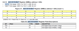

  • Hello Bivin,
    Since you are reading something in register 0x26 for battery voltage, then the ADC should be getting enabled correctly. I was reviewing your outputs more closely and I see, for example, System Voltage (0x26) = 0mV. However, the full range of this ADC is 2.88V to 19.2V so please check your calculation in your script. You can share the actual register dump if it helps. Out of the rest of the ADCs, I would expect ICHG and IDCHG to be 0 as the LSB is very large on these, VBUS should be 0 when powering from BAT, and if you are not using the PSYS feature then this would also be 0. The only one that does not make sense to me is the System voltage (0x26) which should not be 0.

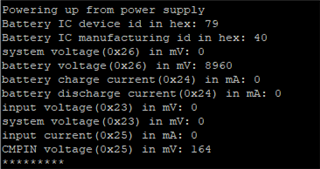

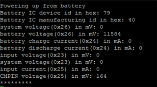

  • Hi Khaild
    I tried reading multiple registers and tried different register read/write sequences, but still I'm having issues in reading ADC registers. Also, i'm not sure whether there is any issue with circuit. Please review the schematic implemented in link below.
    https://e2e.ti.com/support/power-management-group/power-management/f/power-management-forum/1115101/bq25700a-review-on-the-circuit-implemented-using-bq25700a-in-boost-mode
    The values read by powering the circuit from external source of 12V is shown below.
    The values read by powering the circuit from 4S configured battery source (14.8V) is shown below.
    The values  read are incorrect.

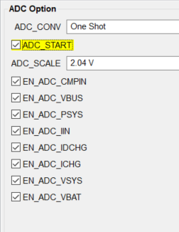

  • Hello Bivin,
    Can you try with TI EVM software (Battery Management Studio) to rule out any issue with your code?
