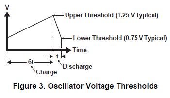

Hi all, I have a working inverting regulator using the MC34063 configured as shown in Figure10 of the TI datasheet.  External timing capacitor Ct should ideally charge and discharge between 0.75 and 1.25 V thresholds, yielding  a voltage delta of 0.5V but I'm seeing  it discharge all the way to 0V which gives a voltage delta of ~1.25V.  Has anyone else seen this behavior?  *the chip is actually an OnSemi variant, my apologies in advance*

  • Hello Jdr,
    How did you determine that the timing capacitor voltage should stay between 0.75V and 1.25V?
    Ron Michallick
  • Hi Ron, I determined this from Application of the MC34063 Switching Regulator, section 1.2:
    "The upper threshold is 1.25 V, which is same as the internal reference voltage, and the lower threshold is
    0.75 V. The oscillator runs constantly, at a pace controlled by the value of CT."

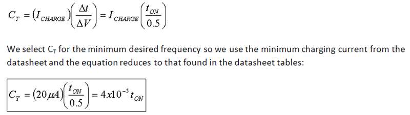

    A 0.5V swing is also used in the derivation for the CT equation:
  • Thanks Jdr,
    This drawing will help with my explanation. The waveform and formula are accurate but not complete. The internal oscillator threshold comparator (with hysteresis) has a propagation delay that is not part of the formula. After the CT voltage hits the threshold voltage (0.75V or 1.25V) the comparator will switch the capacitor current polarity but not until the propagation delay is complete; during this delay the capacitor will continue to charge or discharge. So in addition to the prop delay, the capacitor overshoots the threshold making the delta-V greater further slowing the oscillator. A truly accurate formula would be very complex, but figure 1 in the data sheet shows the relationship between Ct on Ton. This chart is the best method of choosing Ct; much better than the simplified formula.
    In your captured waveform, some of the Ct signal has higher peaks. This is the peak current limit (Rsc=0.3V) increasing the Ct charge rate and shortening Ton during that pulse.
