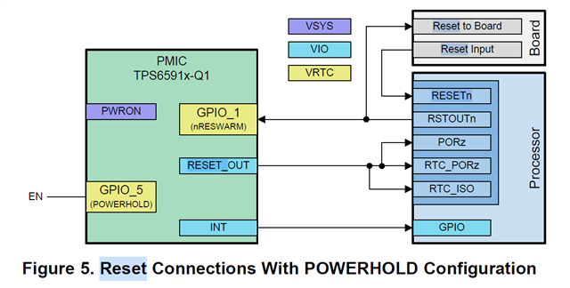

we are designing a new board with AM5716 and the PMIC TPS65917-q1, previously we had the TPS65916 but this is not available any more.
My reference are: SLVSCO4D (TPS65917-Q1 datasheet) and SLVUAX9E (TPS65919-Q1 and TPS65917-Q1 User's Guide).
I have the architecture like in Figure.5 where a FPGA drives the EN (POWERHOLD-GPIO_5 pin of TPS65917) and the Warm Reset (RESETn pin E23 of Sitara). BOOT=1 (connected to LDOVRTC_OUT)
From SLVUAX9E par. 6.3: "A warm reset is triggered by setting NRESWARM (GPIO_1) low, which causes the OFF2ACT sequence to be executed regardless of the actual state (ACTIVE, SLEEP), and the device returns to or remains in the ACTIVE state. [...] Additionally, if BOOT=1, then RESET_OUT is asserted low during the worm reset sequence. [...] If BOOT=1 is used, then the PMIC must be enabled by the POWERHOLD (GPIO_5) pin.[...]. If POWERHOLD is set to GND while BOOT=1, the PMIC will shut off during the warm reset sequence."
My issue are:
  • RESET_OUT doesn't go low when I drive low RESETn of SItara that drives low NRESWARM (GPIO_1) of the PMIC. ARM15 stops working and I have to power off and on.
  • NRESWARM (GPIO_1) and POWERHOLD (GPIO_5) both LOW ARM15 stops working and I have to power off and on.
With PMIC TPS65916 I have to drive LOW and then HIGH both NRESWARM and POWERHOLD in order to have RESET_OUT low and a reboot of the system.

    I have confirmed that one of the differences between the 0x45 and 0x4D OTPs is that the 0x45 asserts RESET_OUT low during a warm reset whereas 0x4D does not (it keeps RESET_OUT at VIO). So the behavior seen is expected.

    I understand what you say but about the RESET_OUT why in SLVUAX9E par. 6.3 they write: "Additionally, if BOOT=1, then RESET_OUT is asserted low during the warm reset sequence"?
    In the new design I configured SMPS12 in dual phase, thank for your remark.
    In order to get a warm reset I force LOW both POWERHOLD/GPIO_5 of the PMIC and RESETn of Sitara. After this, Sitara set LOW NRESWARM/GPIO_1 of the PMIC. When I release both signals, Sitara restart with a Linux reboot. This happens with TPS65916.

  • Hi Francesco,
    I understand your confusion. Later in the User's Guide you reference if you look at Figure 18 it is shown that the RESET_OUT signal stays HI during a warm reset. I agree it can be a bit confusing with the text but that is why the figures are shown to give a better idea of what each signal will do.
