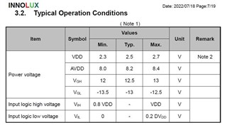

My customer will use new panel from Innolux, but it looks VGL cannot meet the requirement if AVDD is 8.2V.
Could you please provide suggestion for this new panel requirement?
AVDD= 8.2V
VGH= 12.5V
VGL= -13V
Thanks and Best regards,

We found a discussion for adding 2nd stage to have lower voltage for -13V, could you please confirm this is no problem with TPS65150?
Hello Tiger,
Yes, you can add a second stage to the negative charge pump, like discussed in the app note, to achieve more negative VGL voltage.
