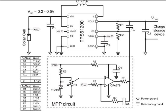

  • Hi
    I am proceeding with the TPS61200 based design with the MPP regulation stage as described in SLVA345A ("Supplying TPS61200 with a single solar cell").
    In a previous thread here (April 2010), there was a discussion relating to modifying the MPP circuit to cater for a different PV module voltage (3V).
    In my case, I have a 3 cell PV module, with Vmpp approximately equal to 1.65V.
    Referring to SLVA345A schematic, I will add a potential divider at Vcell, which will divide down the Vmpp of 1.65V to 1.24V (same as TLV431 reference).  I connect the divided down voltage to R6 on inverting op amp input.  I can omit R4 and connect TLV431 directly to non-inverting op amp input.
    Last year's discussion here confuses me, so I'd like to ask my questions.
    As with the previous poster (almost_linear), I intend to use the bq24071 charge controller, and intend driving this with 4.5V or thereabouts.  So for the TPS61200 above, R1 and R2 would normally be calculated (from datasheet) as R1=R2(Vo/ Vfb -1).  Vfb =0.5V, Vo=4.5V, then R1=8R2.  Setting (for now) R2 at 200k as recommended in datasheet to ensure 1uA of current, then R1 needs to be 1.6M.
    BUT.... what effect on the R1/R2 divider do the op amp components have?    R8 is recommended to be 200k in diagram table above. Does this appear in parallel with R2 or not? (if it is in parallel, then it affects the voltage setting resistor divider).
    In general terms, can someone explain the basis for the chosen value of R8 in particular, but also R7 (and I guess R6).
    Do R7 and C5 just allow a slow ramp up to Vaux according to their RC time constant?
    I do have eval boards, and  I intend building a prototype  this week, but I'd like to understand the component choices as I do so.
    Tony
  • I think you first need to understand how the op amp circuit allows operation at the MPPT.  It does this by feeding a current onto the FB pin which tells the TPS61200 to regulate to a lower output voltage.  This lower output voltage is less output power which is less input power which is less current drawn from the solar cell which allows its voltage to rise.  It will add current to the FB pin if its positive input is higher than its negative input.  This corresponds to a panel voltage that is lower than desired, so it will reduce the output voltage to increase this voltage.
    You can do a KCL on the FB node to see how the R1, R2, and R8 values affect your Vout.  The op amp output voltage varies between ground and Vaux.  You cannot just use the datasheet equation as Vout will vary based on how much light you have.  Make sure to keep the maximum Vout (corresponding to R8 tied to ground) less than the 7V maximum rating for the pin.
    You can simulate the circuit in TINA to find the optimal values for your application.
    Thank you for searching the forum to find other discussions on this topic.

  • For Tony,
    R6 and R7 set a gain of the op amp while C5 is used to slow it down and keep it stable.  I suggest that you start your circuit with these values and then tweak them if needed.

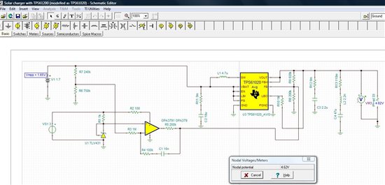

  • Hi Chris
    Thanks for the advice, I spent last night learning and modelling in TINA-TI.  It's a nice tool and I've managed to learn enough about its capabilities to allow me to understand more how the TPS61200 MPP regulator operates.
    In the absence of a macro model for the TPS61200, I've used the model for the TPS61020 which I think is largely similar bar missing the Vaux capability.
    I've just shown the 3 cell PV panel as a voltage source which I directly edit to change its output voltage (above and below specified Vmpp of 1.65V).  The potential divider is 240k and 750k, giving 1.25V to the op amp with Vpanel = 1.65V.  Vopamp output then is close to 0V (196uV).  TPS61020 Vout is 4.62V which is fine.  Vfb resistors are 820k and 200k.
    If I increase PV panel voltage to say 1.9V, everything stays the same, so I think this is ok.  Proabably moving off MPP curve, but current delivery should be maintained.
    If I decrease PV panel voltage to say 1.4V, then opamp output swings to Vaux (which I've just set at 3V in my model).  Voltage at FB pin of TPS61020 now goes to 1.5V and Vout becomes 1.4V.   This is desired behaviour I guess, output power will decrease, thereby decreasing input power and thereby current, allowing panel to float back up to MPP voltage.
    Preparing real prototype now based on above componet values.
