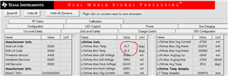

    How to use bqStudio to log the data? They have EV2300 to monitor the battery.
    But only found normal temperature as follow picture, no issue temperature record. is there others way to log temperature?

  • Hello Cherry,
    On the Registers tab, there is a "Start logging" button. Choose a file and let it run for a few hours. Then you can check the log file temperature column data.
