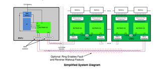

I tested a daisy chain of 3 custom BQ79616 MBBs connected to BQ79600 and MSP430 (SPI interface on custom PCB). One of the MBBs (device 2 in the middle of the daisy chain) has a damaged COMH interface from past ESD testing. When the stack of MBBs is connected to the BQ GUI ,the correct number of functioning stack devices is detected and the auto address sequence completes. The MSP430 firmware however, completes auto addressing only when the correctly functioning number of boards is provided. If the TOTALBOARDS includes the MBB with a damaged COMH interface, the MISO line has no activity, stays at 0xff. I am not aware of any missing register setup in the BQ79616. What can I do to troubleshoot this further-- I don’t have jumpers soldered to the COML lines of the MBBs.
Wakeup appears to complete correctly when the stack includes the MBB with damaged COMH interface. SPI_RDY goes active HIGH and then auto address is not proceeding.

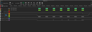

Attached is the screenshot when auto address completes successfully with TOTALBOARDS set to 3 (2 fully working MBBs).
  • Hi Priya,
    The MCU software is designed only to function correctly when proper TOTALBOARDs variable is given based on what is connected. So this is expected behavior.

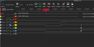

    Thank you for your reply. I did try repeating the auto address sequence if it did not succeed the first time. It does not seem to make a difference in the MISO values. I have one define called MAXBOARDS that is used to allocate arrays that hold BQ response frames. TOTALBOARDS is a uint8_t variable that I decrement when autoaddress does not complete as expected. spiCommands.c uses TOTALBOARDS to calculate the length of the response bytes.  I don't however have any checks for endless loops. What MCU are you using in your project? We use the MSP430FR5962. MISO is always 0xff if I set MAXBOARDS to 4; but the actual number of working boards is only 3.
    Auto address does complete if MAXBOARDS and TOTALBOARDS are both set to 3. I can use pointers on how else to track down where the problem is happening.
