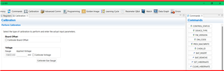

The problem is when the current is 100mA (I read it with a precision tester) the bq AverageCurrent() reports 820 when it should be 1000... this device has an error of 20% with scaled data. I can't admit this error for my application.
Do you know any technique to calibrate current flow through sense resistor? In the Battery Management Studio isn't a box for calibrate current, only has a box for calibrate voltage offset.

    Have you performed the board offset calibration in order to adjust the current? Also when are you reading the average current after the start of current flow? The average current will take some time to stabilize. For is the current reading from the gauge at different applied currents? Is the same offset always present?
    I would also double check with your sense resistor tolerances since this can compound the error. It should have a very low tolerance and low PPM for temperature.

  • Hello Wyatt,
    No, because in Battery Management Studio isn't any mode for make it possible.
    I found a calibration to performed the board offset and battery voltage.
    How can I calibrate the current that flow through resistor?
    Yes, I read the AverageCurrent() value after 60 seconds... and the value doesn't change.
    When I applied different current, the error is more or less constant, about 20%.
    I used a precision resistor with tolerance of 1% 1/2W 50 ppm. In order to comply what it says in paragraph 10.2.2.3 Sense Resistor Selection of bq27441 datasheet.

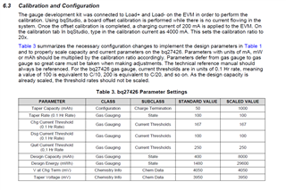

    Can you let me know if the value of taper rate is correctly?
    In the TRM indicates that do not be scale, but I think that the Taper Current must be scaled, since the Coulumb Counter will meassure x10 in my application.
    You can see in this table of slua729.
    So, in my application the Taper Current is 10mA. So, I scaled x10 --> 100mA.
    As sluuap7 says:
    Can you check that parameter?
  • Hello Ruben,
    Since the unit is 0.1 Hr you do not need to scale the Taper Rate, you should scale the Taper Current. When Taper Current is scaled the scale you applied to the design capacity will cancel and you will be left with the same 0.1 hr rate.
