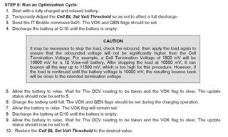

My target battery is 12V 35Ah PbA AGM Valve Regulated type and I'm using the BQ34Z110 most commonly used for PbA.
The 2013 data sheet and posts for PbA applications call for starting with a fully charged relaxed battery before IT Enable.
However, older and newer application reports, SLUA903-July 2018, and SLUA597-MAY2011 call for starting with a fully discharged relaxed battery before IT Enable.
Examples in these reports are for lithium chemistries, so I'm not clear if they apply to PbA.
(1) Can someone explain why for the PbA chemistry, status 5 is to be achieved on discharge, and for lithium chemistry it's on charging?
(2) Which learning cycle procedure is currently recommended for my battery?
(3) Is the modification of the senc file usually required for batteries with high voltage rebound?
(4) After IT Enable 0x0021 is set prior to the first learning cycle attempt, does it need to be reset before starting subsequent attempts?
(5) When is RESET 0x0041 to be used?
(6) Will the learning process accept interference with the voltage rebound?
For instance, once the discharge load reaches the desired termination voltage and is removed,
can I reapply the load in bursts as needed to keep the rebound below the intended termination voltage to achieve the update status 5?
(7) One option to get past the voltage rebound issue is to increase the cell termination voltage and thereby increase the capacity reserve.
After learning is complete, could the BATLOW Alert thresholds be changed to indicate a SOC level below zero but within the reserve range?
This won't create a conflict with the gauging algorithm?
(8) Are these settings still recommended for PbA where voltage rebound is an issue?
Discharge =>C/8 to 1667mv/cell (10V for 6S)
Cell Termination Voltage=1800mV/cell (10.8V)
Cell BL Set Volt Threshold=1600mV/cell (9.6V)
FConvEn=0
I'm getting a voltage rebound of 1.35V which overshoots the 10.8V target by 0.55V.

    I'm not sure what you mean by voltage rebound, when a load is removed from any battery chemistry under high load there will be a voltage "rebound" back to the OCV. You should not provide bursts of current during learning, it should be a constant current discharge down to the terminate voltage. The voltage may rebound but under any load it will immediately drop below terminate due to internal resistance.
    I would follow the guide that is in the BQ34Z100-G1 TRM for reference during the learning cycle process.
    The terminate voltage is where the gauge will force SOC to be 0%. You can set it anywhere you want after learning. During the learning process we need at least a 90% change in DOD between the two relaxation points.
    Sincerely,
    Wyatt Keller
  • Hello Wyatt,
    The BQ34Z110 datasheet SLUSB55B pg30, provides a CAUTION statement regarding voltage rebound. It reads:
    It may be necessary to stop the load, check the rebound, then apply the load again to ensure the rebound voltage will not be significantly higher than the Cell Termination Voltage.
    In the example given for a 12V Lead Acid Battery, like mine, the solution is a DOD to 10V, 0.8V deeper  than the manufacturer's recommended termination voltage of 10.8V.   Then a voltage rebound of 1V would bring the relaxed voltage to 11V, apparently close enough to the intended 10.8V termination voltage.
    SLUA903 pg4 reports that for learning purposes (no specific chemistry), the Termination Voltage should be set to the minimum voltage of the battery as specified in the manufacturers data sheet.   This suggests that the only way to widen the rebound allowable is the DOD, i.e. discharge deeper than the manufacturers spec by an amount equal to the voltage rebound. However BQ34Z100-G1 TRM SLUUBW5A  pg61 warns against this as it may damage the battery.
    From forum posts using BQ34Z110, it appears that voltage rebound has been an issue for PbA chemistries and often resolved when support makes an adjustment to the senc file.
    2021 SEP BQ34Z100-G1 TRM SLUUBW5A (no specific chemistry) suggests discharge to the termination voltage without adjustment, and does not address the voltage rebound problem.
    2018 NOV SLUA925 pg9 has learning cycle instructions for PbA using BQ34Z100,  It suggests to discharge at least 10mv/cell below the cell termination voltage.  Voltage rebound is not addressed.

    I would still recommend trying the learning cycle with the termination at the cell manufacturer limit. If you are not able to get the 90% change in DOD with this method, you can decrease the voltage so when relaxed the cells OCV will be low enough compared to the relaxation at full charge to get the 90% change in DOD. Not all of our documents directly relate to gauges which support PbA chemistry, like SLUA903. What it mostly comes down to is getting enough change of DOD during the learning cycle, you can decrease the load to the minimum C/10, increase charge slightly, or decrease term v slightly to get the same result.

    If I understand your reply, the critical metric for the learning algorithm is the difference between the OCV measurement after fully charged and the OCV measurement following discharge, which you refer to as DOD.  Is this the case?
    This is important to clarify, as I understood  DOD to refer to the voltage drop while under load, i.e. where the passed charge occurs.  It doesn't make sense to me that the 90% passed charge requirement need involve the voltage rebound.  Please explain.

  • Hello Rom,
    Yes that's correct, the DOD value is based on the absolute voltage range which is the chem ID you have programmed.
    The DOD is not connected to the voltage drop or rebound, it is related to the OCV vs DOD table, so it only matters what the relaxed voltage is after a charge or discharge to find the DOD.
    I am not aware of a new feature in the BQ34Z100-G1 that will mitigate the issue, both the BQ34Z110 and BQ34Z100-G1 will have similar logic engines for computing the DOD from the OCV. The main reason for the switch is the updated toolchain, which will help us support you quicker for debug.

  • Hello Wyatt,
    Thank you for clarification of DOD for gauging.  It's not what I thought.
    But with regard to the voltage bounce back, it seems something changed given he BQ34Z110 datasheet cautionary statement.
    It recommends dropping discharge termination below normal to ensure the resulting voltage bounce back will be close to the intended termination voltage.  I don't see this recommendation, or even a mention of this issue in documentation for the newer generations.
    Was this recommendation faulty or are the learning algorithms with BQ34Z100-G1/STUDIO more tolerant of voltage rebound than with BQ34Z110/bqEVSW?
    Sincerely,
    Rom
  • Hello Rom,
    I believe the caution is just a suggestion for if you do run into an issue. Most of the time it will probably be okay not to lower the threshold. I'm not sure exactly why it was removed from the other documents. There is no significant difference in the learning algorithm between the two gauges. If you want to be extra cautious you can decrease the termination slightly lower to ensure the 90% DOD change.
    Sincerely,
    Wyatt Keller
