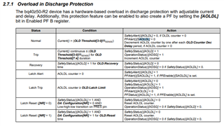

I have 3-S pack with BQ40Z50-R2 . After AOLDL or ASCDL trigger.  The output can not resume to normal.  AOLDL or  ASCDL flag keep red with moment clear.
Setting below for AOLDL and ASCDL.  attahment the GG file.
