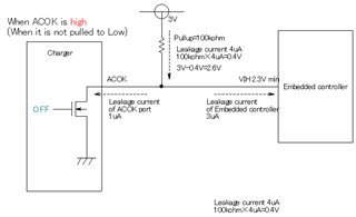

BQ24800: About ACOK pullup resistor
Part Number: BQ24800
I have a question.
The pin function is descripted that ACOK pull-up is 10kohm.
But We think that ACOK pull-up resistor is changed to more big resistance for example 100kohm for reduce current consumption.
(1) When the below diagram condition of ACOK is High, Is pull-up 100kohm no problem? If you have the notification, please teach the it.

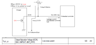

(2) When the below diagram condition of ACOK is Low, Is pull-up 100kohm no problem? If you have the notification, please teach the it.
