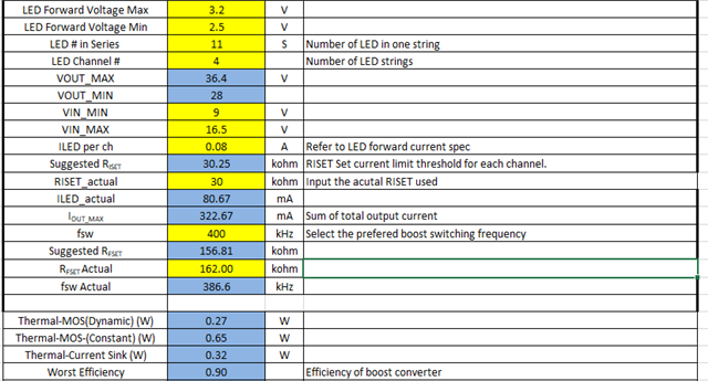

Using LP8867C-Q1 to drive 11 series and 4 parallel LED strings, each string is 80mA/35V.
How to calculate PLOSS on LP8867C-Q1? Because we need to know PLOSS to calculate Tj.
