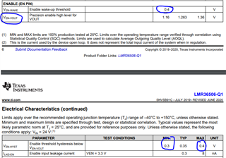

Datasheet mentions if EN pin voltage is above 0.4v then IC wakes up, but there is another tab Ven_Vout : 1.6V to 1.36V with typical 1.263V
which one of this is true ?
When V_EN goes above 0.4 IC Wakes up does it start switching ? or do we need to exceed 1.36V to start switching ?
V_EN pin threshold :min is 0.3V , max is 0.4V.
does this mean when IC is switching, if we decrease VEN to 0.3V or Below then IC will turn OFF and when V_EN increases above 0.4V IC will turn ON ?

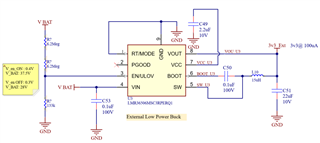

My application is powered up by 60V battery which needs to be disconnected when V_BAT is below 30V.
so 0.4V OR 1.36V is very crucial for deciding the voltage divider at EN Pin.
below is schematic snap shot
let me know at what voltage 3v3 will be available at output (0.4V or 1.36V)
