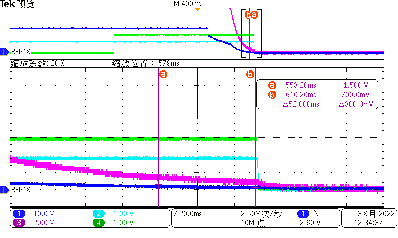

I notice if LD pin is higher than 1.4V, then BQ76952 shutdown sequence will pause until LD pin drop lower than 1.4V. I wonder after LD pin drop lower than 1.4V, how long need to shutdown BQ76952 or turn off REG18?
In my 1st test as shown in FIG.1, the DSG/CHG FET were on, then start shutdown command. With DSG FET turn off, the LD pin voltage is droping from VBAT. After LD pin drop below 1.4V, it takes 52ms to shutdown REG18.

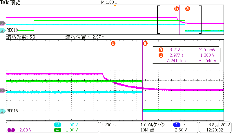

However in my 2nd test as shown in FIG2, the DSG/CHG FET were off, but 3.3V voltage was on LD pin. Then, start shutdown sequence and turn off 3.3V on LD pin. It can be seen after LD pin drop below 1.4V, it takes 241ms to shutdown REG18.

FIG.1 CH1 DSG PIN, CH2 REG18, CH3 LD PIN, CH4 RST_SHUT PIN
FIG.2 CH2 REG18, CH3 LD PIN, CH4 RST_SHUT PIN
  • Hi Jiatu,
    The slope of the curve on your LD pin is very slow and the LD voltage threshold is not precisely at 1.45V. See the datasheet spec below - there is a wide range on this spec:
    In order to test the Shutdown timing more accurately, you need a faster transition on the LD pin. For example, if you quickly transition from 2.5V to 0V on the LD pin, you can measure the time it takes for REG18 to power off.
    Matt
