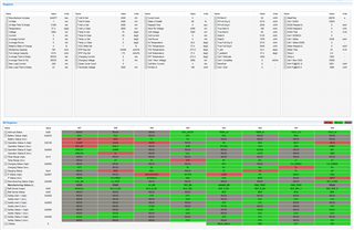

  • Update:  I should have mentioned that, although the chip is mounted on our custom PCB, I have brought out the I2C interface and have it communicating with BQStudio, so it should be easy to examine and modify any registers in the device as needed.
  • Here's a snapshot of the current state of the registers.  (Pardon the squinty eye chart -- if there's a better way to convey the info, please let me know!)  My 'scope tells me that at least one of the FETs is off -- perhaps because the chip is in SLEEP mode?
  • The bq27z746 is self-sufficient in the sense that once it powers up and if it was configured in the past, it will run without the need for configuration. The FETs are controlled by a complex rule set (see TRM https://www.ti.com/lit/ug/sluuca6/sluuca6.pdf, Chapter 4) which are too many to discuss in general on E2E.
    Your register screen shot shows that both FETs are off (XCHG and XDSG are red).
    Please check the setting for FET Options (4.3.13). The gauge will not in all cases disable FETs in sleep. You can control behavior with this register. What are your settings?
