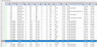

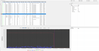

    Here's a capture of a charging session that was abruptly ended on the above design (https://drive.google.com/file/d/16L5JorXqeEDNW_i5gdNowTCITL-KL6BN/view?usp=sharing or as a CSV: drive.google.com/.../view, and I'm attaching a capture of a charging session with the same sink (a usb-c laptop) against another design that works (https://drive.google.com/file/d/1VkVihXieOtNnuVL3zM8RIK9ufdV5v9tn/view?usp=sharing). And here's a ("good") session with the same sink against the TPS65987EVM (eval board for the TPS65987) that we also used for comparison: https://drive.google.com/file/d/14FKFMus1wjGS71O4gLqwbk0CWNcfb37T/view?usp=sharing
    These can be opened using the CY4500 EZ-PD Analyzer Utility (free download from the infineon.com link above). In the case where were able to successfully hold a continuous charging session, we noticed that we lock in ~ 2.8A and are able to hold there. In the case where we get the spurious disconnects, it seems like we're getting to the same current, but get disconnected after a few milliseconds (see screenshots). This happens on repeat as automatic retries occur.

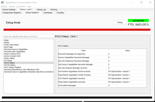

  • Hi Raymond, I don't seem to have that section. Here's what I have for Debug Registers:

  • Hi Raymond, thanks for that. I took a video of the various settings, starting with the PD3.0 Status:
    https://drive.google.com/file/d/11NPOIv5_ww9R7gpt1t4DEYigagfjtDkv/view?usp=sharing
    and here's an exported PD data capture for that session:
    https://drive.google.com/file/d/10_YRJ3uy5g82dEq6QIgS20uWVkNZr_r9/view?usp=sharing
    I'm not sure what could be causing the USB connection to spontaneously drop. I have a cell phone that charges just fine @ 9V/3A. And this laptop that produced this session will get a good charging session if I limit the power supply to 18V, but allowing anything above that, I get these spontaneous disconnects.

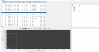

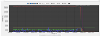

    I've got another interesting data point. I've been using a usb-c laptop as a sink, and with the laptop closed/sleeping, it'll pull ~ 2.5A-2.7A @ 20V, so we can properly switch and charge on PDO4, but the second I open the laptop, you can see a rise in current, likely from the laptop pulling more to power the screen or engage performance mode settings, and the charging is immediately cut:

    No luck on any of those. I also tried to increase PDO4's current limit to 5A from 3A as our power supply can easily handle that, and I was looking to see is stepping over 3A was causing some over-current protection to kick in, but got a similar outcome:
    I also captured some Debug Logs from the application customization tool:
     ti-logs-20220817.csv
    There's mention in there of entering UVP state, but not sure if that's applying to the output, or if it's infact related.

  • Hi Raymond, sorry for the delay. I'm just returning to this. With DRP, and turning off sink PDOs, there was no improvement - I still get the disconnects. One additional data point is that with just the USB analyzer running (recording), I do see the CC lines flipping between some mV value and 0. Voltage and Current also cycle between 0 and some low value like 5mV and 2mA.
    This doesn't happen on our working reference board - it will keep a consistent 2mA, probably owing to a little draw by the USB analyzer, so maybe this is a SMT/assembly issue at this point. I've been exploring getting more test boards made.
