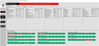

  • 1. RESET does not return Battery into Sealed mode. I tried with the two battery BMS.
    2. after RESET , RSOC is continuously showing 0% even after cell charge voltage is above 3.7V. don`t know why ?
    3.  RCA and FD bit is still on.
  • Hello Bhupendra,
    This gauges are not recommended to RESET frequently.
    The reason why you might be seeing a 0% RSOC is because maybe an OCV measurement was taken at a high DOD point where Remaining Capacity might be close to zero or zero.
    Would you please share your log file to better debug this issue?

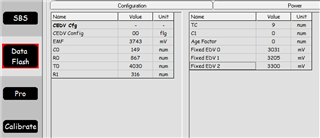

  • Hello Jose,
    We are doing RESET , because we are not aware about for which parameter need to execute RESET Condition.....
    Here , i am attaching .gg file FYR.
    Pls. let us know , if you need anything else.... bQ3050-7Ah.zip
    FYI:Here is my Battery (4S) Design requirement :
    Max. Pack Charge Voltage : 16.4 ( Cell Voltage = 4100mV Max.) , EDV Fix method.
    Max. Pack Discharge Voltage : 12.8 ( Cell Voltage = 3200mV max ) after that DSG MOSFET must be OFF to provide  0V pack output.

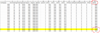

  • Hello Bhupendra,
    Would you please attach your log file (this file keeps record of battery status, flags, voltage, current, etc).
    Jose
  • Pls. find attached one.
    I See the Jump when Cell voltage discharge crosses to EDV2 Threshold....Should I reduce EDV2 threshold from 3500mV to 3300mV ?

    93	4:48:37 PM	3681	0000	285	10	0081	0	65535	65535	1	32.65	15113	-2156	-2156	100	70	71	4764	6900	133	133	65535	1400	16800	00C0	1	3774	3795	3783	3762	0006	0000	0000	0000	0000	8044	0200	0008	14004	0000
    94	4:49:17 PM	3721	0000	285	10	0081	0	65535	65535	1	32.75	15095	-2153	-2153	100	69	70	4726	6900	132	132	65535	1400	16800	00C0	1	3769	3790	3778	3757	0006	0000	0000	0000	0000	8044	0200	0008	14004	0000
    95	4:49:57 PM	3761	0000	285	10	0081	0	65535	65535	1	32.75	15086	-2152	-2152	100	69	70	4707	6900	131	131	65535	1400	16800	00C0	1	3767	3788	3776	3755	0006	0000	0000	0000	0000	8044	0200	0008	14004	0000
    96	4:50:37 PM	3801	0000	285	10	0081	0	65535	65535	1	32.75	15077	-2150	-2151	100	68	69	4688	6900	131	131	65535	1400	16800	00C0	1	3765	3786	3773	3753	0006	0000	0000	0000	0000	8044	0200	0008	14004	0000
    97	4:51:17 PM	3841	0000	285	10	0081	0	65535	65535	1	32.75	15057	-2148	-2148	100	68	69	4651	6900	130	130	65535	1400	16800	00C0	1	3760	3781	3768	3748	0006	0000	0000	0000	0000	8044	0200	0008	14004	0000
    98	4:51:57 PM	3881	0000	285	10	0081	0	65535	65535	1	32.75	15049	-2146	-2147	100	68	69	4632	6900	130	129	65535	1400	16800	00C0	1	3758	3778	3766	3746	0006	0000	0000	0000	0000	8044	0200	0008	14004	0000
    99	4:52:37 PM	3921	0000	285	10	0081	0	65535	65535	1	32.75	15038	-2145	-2145	100	67	68	4613	6900	129	129	65535	1400	16800	00C0	1	3755	3776	3764	3743	0006	0000	0000	0000	0000	8044	0200	0008	14004	0000
    100	4:53:17 PM	3961	0000	285	10	0081	0	65535	65535	1	32.75	15030	-2143	-2144	100	67	68	4595	6900	129	129	65535	1400	16800	00C0	1	3753	3774	3761	3741	0006	0000	0000	0000	0000	8044	0200	0008	14004	0000
    101	4:53:57 PM	4001	0000	285	10	0081	0	65535	65535	1	32.75	15011	-2140	-2141	100	67	68	4557	6900	128	128	65535	1400	16800	00C0	1	3749	3769	3757	3736	0006	0000	0000	0000	0000	8044	0200	0008	14004	0000
    102	4:54:37 PM	4041	0000	285	10	0081	0	65535	65535	1	32.75	15000	-2139	-2139	100	66	67	4538	6900	127	127	65535	1400	16800	00C0	1	3746	3766	3754	3734	0006	0000	0000	0000	0000	8044	0200	0008	14004	0000
    103	4:55:17 PM	4081	0000	285	10	0081	0	65535	65535	1	32.85	14991	-2138	-2138	100	66	67	4520	6900	127	127	65535	1400	16800	00C0	1	3744	3764	3752	3731	0006	0000	0000	0000	0000	8044	0200	0008	14004	0000
    104	4:55:57 PM	4121	0000	285	10	0081	0	65535	65535	1	32.75	14980	-2136	-2137	100	66	67	4501	6900	126	126	65535	1400	16800	00C0	1	3741	3761	3749	3729	0006	0000	0000	0000	0000	8044	0200	0008	14004	0000
    105	4:56:37 PM	4161	0000	285	10	0081	0	65535	65535	1	32.85	14960	-2134	-2134	100	65	66	4463	6900	125	125	65535	1400	16800	00C0	1	3737	3756	3744	3724	0006	0000	0000	0000	0000	8044	0200	0008	14004	0000
    106	4:57:17 PM	4201	0000	285	10	0081	0	65535	65535	1	32.85	14949	-2132	-2133	100	65	66	4445	6900	125	125	65535	1400	16800	00C0	1	3734	3753	3741	3721	0006	0000	0000	0000	0000	8044	0200	0008	14004	0000
    107	4:57:57 PM	4241	0000	285	10	0081	0	65535	65535	1	32.85	14940	-2131	-2131	100	65	66	4426	6900	125	125	65535	1400	16800	00C0	1	3731	3751	3739	3718	0006	0000	0000	0000	0000	8044	0200	0008	14004	0000
    108	4:58:37 PM	4281	0000	285	10	0081	0	65535	65535	1	32.75	14929	-2129	-2130	100	64	65	4408	6900	124	124	65535	1400	16800	00C0	1	3729	3748	3736	3716	0006	0000	0000	0000	0000	8044	0200	0008	14004	0000
    109	4:59:17 PM	4321	0000	285	10	0081	0	65535	65535	1	32.75	14909	-2126	-2126	100	64	65	4370	6900	123	123	65535	1400	16800	00C0	1	3724	3743	3731	3710	0006	0000	0000	0000	0000	8044	0200	0008	14004	0000
    110	4:59:57 PM	4361	0000	285	10	0081	0	65535	65535	1	32.75	14897	-2124	-2125	100	64	64	4351	6900	123	123	65535	1400	16800	00C0	1	3721	3740	3728	3708	0006	0000	0000	0000	0000	8044	0200	0008	14004	0000
    111	5:00:37 PM	4401	0000	285	10	0081	0	65535	65535	1	32.75	14887	-2123	-2124	100	63	64	4333	6900	122	122	65535	1400	16800	00C0	1	3719	3737	3726	3705	0006	0000	0000	0000	0000	8044	0200	0008	14004	0000
    112	5:01:17 PM	4441	0000	285	10	0081	0	65535	65535	1	32.75	14865	-2120	-2121	100	63	64	4295	6900	122	121	65535	1400	16800	00C0	1	3713	3732	3720	3700	0006	0000	0000	0000	0000	8044	0200	0008	14004	0000
    113	5:01:57 PM	4481	0000	285	10	0081	0	65535	65535	1	32.75	14855	-2118	-2119	100	62	63	4277	6900	121	121	65535	1400	16800	00C0	1	3711	3730	3717	3697	0006	0000	0000	0000	0000	8044	0200	0008	14004	0000
    114	5:02:37 PM	4521	0000	285	10	0081	0	65535	65535	1	32.85	14844	-2116	-2117	100	62	63	4258	6900	121	121	65535	1400	16800	00C0	1	3708	3727	3715	3694	0006	0000	0000	0000	0000	8044	0200	0008	14004	0000
    115	5:03:17 PM	4561	0000	285	10	0081	0	65535	65535	1	32.75	14833	-2115	-2116	100	62	63	4240	6900	120	120	65535	1400	16800	00C0	1	3705	3724	3712	3692	0006	0000	0000	0000	0000	8044	0200	0008	14004	0000
    116	5:03:57 PM	4601	0000	285	10	0081	0	65535	65535	1	32.75	14811	-2112	-2113	100	61	62	4203	6900	119	119	65535	1400	16800	00C0	1	3700	3719	3706	3686	0006	0000	0000	0000	0000	8044	0200	0008	14004	0000
    117	5:04:37 PM	4641	0000	285	10	0081	0	65535	65535	1	32.75	14799	-2111	-2111	100	61	62	4184	6900	119	119	65535	1400	16800	00C0	1	3697	3716	3703	3683	0006	0000	0000	0000	0000	8044	0200	0008	14004	0000
    118	5:05:17 PM	4681	0000	285	10	0081	0	65535	65535	1	32.85	14790	-2109	-2110	100	61	62	4165	6900	118	118	65535	1400	16800	00C0	1	3695	3713	3701	3680	0006	0000	0000	0000	0000	8044	0200	0008	14004	0000
    119	5:05:57 PM	4721	0000	285	10	0081	0	65535	65535	1	32.75	14779	-2107	-2108	100	61	61	4147	6900	118	118	65535	1400	16800	00C0	1	3692	3710	3698	3678	0006	0000	0000	0000	0000	8044	0200	0008	14004	0000
    120	5:06:37 PM	4761	0000	285	10	0081	0	65535	65535	1	32.75	14755	-2104	-2105	100	60	61	4109	6900	117	117	65535	1400	16800	00C0	1	3686	3705	3692	3672	0006	0000	0000	0000	0000	8044	0200	0008	14004	0000
    121	5:07:17 PM	4801	0000	285	10	0081	0	65535	65535	1	32.75	14745	-2103	-2103	100	60	61	4091	6900	117	117	65535	1400	16800	00C0	1	3684	3702	3689	3669	0006	0000	0000	0000	0000	8044	0200	0008	14004	0000
    122	5:07:57 PM	4841	0000	285	10	0081	0	65535	65535	1	32.75	14733	-2101	-2102	100	60	60	4073	6900	116	116	65535	1400	16800	00C0	1	3681	3699	3686	3666	0006	0000	0000	0000	0000	8044	0200	0008	14004	0000
    123	5:08:37 PM	4881	0000	285	10	0081	0	65535	65535	1	32.75	14723	-2099	-2100	100	59	60	4054	6900	116	116	65535	1400	16800	00C0	1	3678	3697	3684	3664	0006	0000	0000	0000	0000	8044	0200	0008	14004	0000
    124	5:09:17 PM	4921	0000	285	10	0081	0	65535	65535	1	32.75	14700	-2096	-2097	100	59	60	4017	6900	115	115	65535	1400	16800	00C0	1	3673	3691	3678	3658	0006	0000	0000	0000	0000	8044	0200	0008	14004	0000
    125	5:09:57 PM	4961	0000	285	10	0081	0	65535	65535	1	32.75	14689	-2094	-2095	100	58	59	3999	6900	115	115	65535	1400	16800	00C0	1	3670	3689	3675	3655	0006	0000	0000	0000	0000	8044	0200	0008	14004	0000
    126	5:10:37 PM	5001	0000	285	10	0081	0	65535	65535	1	32.65	14678	-2093	-2093	100	58	59	3980	6900	114	114	65535	1400	16800	00C0	1	3667	3686	3672	3652	0006	0000	0000	0000	0000	8044	0200	0008	14004	0000
    127	5:11:17 PM	5041	0000	285	10	0081	0	65535	65535	1	32.65	14666	-2091	-2092	100	58	59	3962	6900	114	114	65535	1400	16800	00C0	1	3664	3683	3669	3650	0006	0000	0000	0000	0000	8044	0200	0008	14004	0000
    128	5:11:57 PM	5081	0000	285	10	0081	0	65535	65535	1	32.65	14643	-2087	-2088	100	57	58	3925	6900	113	113	65535	1400	16800	00C0	1	3658	3677	3664	3644	0006	0000	0000	0000	0000	8044	0200	0008	14004	0000
    129	5:12:37 PM	5121	0000	285	10	0081	0	65535	65535	1	32.65	14632	-2086	-2087	100	57	58	3907	6900	112	112	65535	1400	16800	00C0	1	3656	3674	3661	3641	0006	0000	0000	0000	0000	8044	0200	0008	14004	0000
    130	5:13:17 PM	5161	0000	285	10	0081	0	65535	65535	1	32.65	14622	-2084	-2085	100	57	58	3888	6900	112	112	65535	1400	16800	00C0	1	3653	3672	3658	3639	0006	0000	0000	0000	0000	8044	0200	0008	14004	0000
    131	5:13:57 PM	5201	0000	285	10	0081	0	65535	65535	1	32.65	14610	-2083	-2084	100	57	57	3870	6900	111	111	65535	1400	16800	00C0	1	3650	3669	3655	3636	0006	0000	0000	0000	0000	8044	0200	0008	14004	0000
    132	5:14:37 PM	5241	0000	285	10	0081	0	65535	65535	1	32.65	14588	-2079	-2080	100	56	57	3833	6900	111	111	65535	1400	16800	00C0	1	3645	3663	3650	3630	0006	0000	0000	0000	0000	8044	0200	0008	14004	0000
    133	5:15:17 PM	5281	0000	285	10	0081	0	65535	65535	1	32.55	14578	-2078	-2079	100	56	57	3815	6900	110	110	65535	1400	16800	00C0	1	3642	3660	3647	3628	0006	0000	0000	0000	0000	8044	0200	0008	14004	0000
    134	5:15:57 PM	5321	0000	285	10	0081	0	65535	65535	1	32.55	14566	-2076	-2077	100	56	56	3797	6900	110	110	65535	1400	16800	00C0	1	3639	3658	3644	3625	0006	0000	0000	0000	0000	8044	0200	0008	14004	0000
    135	5:16:37 PM	5361	0000	285	10	0081	0	65535	65535	1	32.55	14555	-2075	-2076	100	55	56	3779	6900	109	109	65535	1400	16800	00C0	1	3636	3655	3642	3622	0006	0000	0000	0000	0000	8044	0200	0008	14004	0000
    136	5:17:17 PM	5401	0000	285	10	0081	0	65535	65535	1	32.55	14534	-2071	-2072	100	55	56	3742	6900	108	108	65535	1400	16800	00C0	1	3631	3650	3636	3617	0006	0000	0000	0000	0000	8044	0200	0008	14004	0000
    137	5:17:57 PM	5441	0000	285	10	0081	0	65535	65535	1	32.55	14522	-2070	-2071	100	54	55	3724	6900	108	108	65535	1400	16800	00C0	1	3628	3647	3633	3614	0006	0000	0000	0000	0000	8044	0200	0008	14004	0000
    138	5:18:37 PM	5481	0000	285	10	0081	0	65535	65535	1	32.55	14512	-2068	-2069	100	54	55	3705	6900	107	107	65535	1400	16800	00C0	1	3625	3644	3631	3612	0006	0000	0000	0000	0000	8044	0200	0008	14004	0000
    139	5:19:17 PM	5521	0000	285	10	0081	0	65535	65535	1	32.55	14502	-2067	-2068	100	54	55	3688	6900	107	107	65535	1400	16800	00C0	1	3623	3642	3628	3609	0006	0000	0000	0000	0000	8044	0200	0008	14004	0000
    140	5:19:57 PM	5561	0000	285	10	0081	0	65535	65535	1	32.45	14481	-2064	-2065	100	53	54	3651	6900	106	106	65535	1400	16800	00C0	1	3617	3636	3623	3604	0006	0000	0000	0000	0000	8044	0200	0008	14004	0000
    141	5:20:37 PM	5601	0000	285	10	0081	0	65535	65535	1	32.45	14471	-2063	-2063	100	53	54	3633	6900	106	106	65535	1400	16800	00C0	1	3615	3634	3620	3602	0006	0000	0000	0000	0000	8044	0200	0008	14004	0000
    142	5:21:17 PM	5641	0000	285	10	0081	0	65535	65535	1	32.45	14460	-2061	-2062	100	53	54	3615	6900	105	105	65535	1400	16800	00C0	1	3612	3631	3618	3599	0006	0000	0000	0000	0000	8044	0200	0008	14004	0000
    143	5:21:57 PM	5681	0000	285	10	0081	0	65535	65535	1	32.45	14440	-2058	-2059	100	52	53	3579	6900	104	104	65535	1400	16800	00C0	1	3607	3626	3613	3594	0006	0000	0000	0000	0000	8044	0200	0008	14004	0000
    144	5:22:37 PM	5721	0000	285	10	0081	0	65535	65535	1	32.45	14430	-2056	-2057	100	52	53	3560	6900	104	104	65535	1400	16800	00C0	1	3605	3624	3610	3591	0006	0000	0000	0000	0000	8044	0200	0008	14004	0000
    145	5:23:17 PM	5761	0000	285	10	0081	0	65535	65535	1	32.45	14420	-2055	-2056	100	52	53	3542	6900	103	103	65535	1400	16800	00C0	1	3602	3621	3608	3589	0006	0000	0000	0000	0000	8044	0200	0008	14004	0000
    146	5:23:57 PM	5801	0000	285	10	0081	0	65535	65535	1	32.45	14411	-2054	-2054	100	52	52	3524	6900	103	103	65535	1400	16800	00C0	1	3599	3618	3605	3587	0006	0000	0000	0000	0000	8044	0200	0008	14004	0000
    147	5:24:37 PM	5841	0000	285	10	0081	0	65535	65535	1	32.35	14392	-2051	-2051	100	51	52	3488	6900	102	102	65535	1400	16800	00C0	1	3595	3614	3601	3582	0006	0000	0000	0000	0000	8044	0200	0008	14004	0000
    148	5:25:17 PM	5881	0000	285	10	0081	0	65535	65535	1	32.45	14381	-2050	-2050	100	51	52	3470	6900	102	102	65535	1400	16800	00C0	1	3592	3611	3598	3580	0006	0000	0000	0000	0000	8044	0200	0008	14004	0000
    149	5:25:57 PM	5921	0000	285	10	0081	0	65535	65535	1	32.45	14372	-2048	-2049	100	51	51	3453	6900	101	101	65535	1400	16800	00C0	1	3590	3609	3596	3577	0006	0000	0000	0000	0000	8044	0200	0008	14004	0000
    150	5:26:37 PM	5961	0000	285	10	0081	0	65535	65535	1	32.45	14363	-2046	-2047	100	50	51	3434	6900	101	101	65535	1400	16800	00C0	1	3588	3607	3593	3575	0006	0000	0000	0000	0000	8044	0200	0008	14004	0000
    151	5:27:17 PM	6001	0000	285	10	0081	0	65535	65535	1	32.35	14345	-2044	-2044	100	50	50	3399	6900	100	100	65535	1400	16800	00C0	1	3583	3602	3589	3571	0006	0000	0000	0000	0000	8044	0200	0008	14004	0000
    152	5:27:57 PM	6041	0000	285	10	0081	0	65535	65535	1	32.35	14337	-2043	-2043	100	49	50	3381	6900	99	99	65535	1400	16800	00C0	1	3581	3600	3587	3569	0006	0000	0000	0000	0000	8044	0200	0008	14004	0000
    153	5:28:37 PM	6081	0000	285	10	0081	0	65535	65535	1	32.35	14328	-2041	-2042	100	49	50	3363	6900	99	99	65535	1400	16800	00C0	1	3579	3598	3585	3566	0006	0000	0000	0000	0000	8044	0200	0008	14004	0000
    154	5:29:17 PM	6121	0000	285	10	0081	0	65535	65535	1	32.25	14318	-2040	-2041	100	49	50	3345	6900	98	98	65535	1400	16800	00C0	1	3576	3596	3582	3564	0006	0000	0000	0000	0000	8044	0200	0008	14004	0000
    155	5:29:57 PM	6161	0000	285	10	0081	0	65535	65535	1	32.25	14301	-2037	-2038	100	48	49	3310	6900	97	97	65535	1400	16800	00C0	1	3572	3591	3578	3560	0006	0000	0000	0000	0000	8044	0200	0008	14004	0000
    156	5:30:37 PM	6201	0000	285	10	0081	0	65535	65535	1	32.25	14293	-2036	-2037	100	48	49	3292	6900	97	97	65535	1400	16800	00C0	1	3570	3589	3576	3558	0006	0000	0000	0000	0000	8044	0200	0008	14004	0000
    157	5:31:17 PM	6241	0000	285	10	0081	0	65535	65535	1	32.35	14285	-2035	-2036	100	48	49	3274	6900	97	96	65535	1400	16800	00C0	1	3568	3587	3574	3556	0006	0000	0000	0000	0000	8044	0200	0008	14004	0000
    158	5:31:57 PM	6281	0000	285	10	0081	0	65535	65535	1	32.25	14267	-2033	-2033	100	47	48	3238	6900	96	96	65535	1400	16800	00C0	1	3563	3583	3569	3552	0006	0000	0000	0000	0000	8044	0200	0008	14004	0000
    159	5:32:37 PM	6321	0000	285	10	0081	0	65535	65535	1	32.25	14259	-2032	-2032	100	47	48	3221	6900	95	95	65535	1400	16800	00C0	1	3561	3581	3567	3549	0006	0000	0000	0000	0000	8044	0200	0008	14004	0000
    160	5:33:17 PM	6361	0000	285	10	0081	0	65535	65535	1	32.25	14250	-2030	-2031	100	47	48	3203	6900	95	95	65535	1400	16800	00C0	1	3559	3578	3565	3547	0006	0000	0000	0000	0000	8044	0200	0008	14004	0000
    161	5:33:57 PM	6401	0000	285	10	0081	0	65535	65535	1	32.35	14241	-2029	-2030	100	47	47	3185	6900	94	94	65535	1400	16800	00C0	1	3557	3576	3563	3545	0006	0000	0000	0000	0000	8044	0200	0008	14004	0000
    162	5:34:37 PM	6441	0000	285	10	0081	0	65535	65535	1	32.25	14225	-2027	-2027	100	46	47	3150	6900	93	93	65535	1400	16800	00C0	1	3553	3572	3559	3541	0006	0000	0000	0000	0000	8044	0200	0008	14004	0000
    163	5:35:17 PM	6481	0000	285	10	0081	0	65535	65535	1	32.25	14217	-2025	-2026	100	46	47	3132	6900	93	93	65535	1400	16800	00C0	1	3551	3570	3557	3539	0006	0000	0000	0000	0000	8044	0200	0008	14004	0000
    164	5:35:57 PM	6521	0000	285	10	0081	0	65535	65535	1	32.25	14209	-2024	-2025	100	46	46	3114	6900	92	92	65535	1400	16800	00C0	1	3549	3568	3555	3537	0006	0000	0000	0000	0000	8044	0200	0008	14004	0000
    165	5:36:37 PM	6561	0000	285	10	0081	0	65535	65535	1	32.25	14201	-2023	-2023	100	45	46	3096	6900	92	92	65535	1400	16800	00C0	1	3547	3566	3553	3535	0006	0000	0000	0000	0000	8044	0200	0008	14004	0000
    166	5:37:17 PM	6601	0000	285	10	0081	0	65535	65535	1	32.25	14186	-2020	-2021	100	45	46	3061	6900	91	91	65535	1400	16800	00C0	1	3543	3562	3550	3531	0006	0000	0000	0000	0000	8044	0200	0008	14004	0000
    167	5:37:57 PM	6641	0000	285	10	0081	0	65535	65535	1	32.25	14179	-2020	-2020	100	45	45	3044	6900	90	90	65535	1400	16800	00C0	1	3541	3560	3548	3529	0006	0000	0000	0000	0000	8044	0200	0008	14004	0000
    168	5:38:37 PM	6681	0000	285	10	0081	0	65535	65535	1	32.25	14170	-2019	-2019	100	44	45	3026	6900	90	90	65535	1400	16800	00C0	1	3539	3558	3546	3527	0006	0000	0000	0000	0000	8044	0200	0008	14004	0000
    169	5:39:17 PM	6721	0000	285	10	0081	0	65535	65535	1	32.15	14163	-2018	-2018	100	44	45	3008	6900	89	89	65535	1400	16800	00C0	1	3537	3556	3544	3525	0006	0000	0000	0000	0000	8044	0200	0008	14004	0000
    170	5:39:57 PM	6761	0000	285	10	0081	0	65535	65535	1	32.15	14147	-2015	-2016	100	44	44	2973	6900	89	88	65535	1400	16800	00C0	1	3533	3552	3540	3522	0006	0000	0000	0000	0000	8044	0200	0008	14004	0000
    171	5:40:37 PM	6801	0000	285	10	0081	0	65535	65535	1	32.15	14138	-2014	-2015	100	43	44	2955	6900	88	88	65535	1400	16800	00C0	1	3531	3550	3538	3519	0006	0000	0000	0000	0000	8044	0200	0008	14004	0000
    172	5:41:17 PM	6841	0000	285	10	0081	0	65535	65535	1	32.15	14130	-2012	-2013	100	43	44	2938	6900	88	88	65535	1400	16800	00C0	1	3529	3548	3536	3517	0006	0000	0000	0000	0000	8044	0200	0008	14004	0000
    173	5:41:57 PM	6881	0000	285	10	0081	0	65535	65535	1	32.15	14122	-2011	-2012	100	43	43	2920	6900	87	87	65535	1400	16800	00C0	1	3527	3545	3534	3516	0006	0000	0000	0000	0000	8044	0200	0008	14004	0000
    174	5:42:37 PM	6921	0000	285	10	0081	0	65535	65535	1	32.15	14106	-2009	-2010	100	42	43	2885	6900	86	86	65535	1400	16800	00C0	1	3523	3541	3530	3512	0006	0000	0000	0000	0000	8044	0200	0008	14004	0000
    175	5:43:17 PM	6961	0000	285	10	0081	0	65535	65535	1	32.15	14098	-2009	-2009	100	42	43	2867	6900	86	86	65535	1400	16800	00C0	1	3521	3539	3528	3510	0006	0000	0000	0000	0000	8044	0200	0008	14004	0000
    176	5:43:57 PM	7001	0000	285	10	0081	0	65535	65535	1	32.15	14090	-2007	-2007	100	42	42	2850	6900	85	85	65535	1400	16800	00C0	1	3519	3537	3526	3508	0006	0000	0000	0000	0000	8044	0200	0008	14004	0000
    177	5:44:37 PM	7041	0000	285	10	0081	0	65535	65535	1	32.15	14075	-2005	-2005	100	41	42	2815	6900	84	84	65535	1400	16800	00C0	1	3515	3534	3522	3504	0006	0000	0000	0000	0000	8044	0200	0008	14004	0000
    178	5:45:17 PM	7081	0000	285	10	0081	0	65535	65535	1	32.15	14067	-2004	-2004	100	41	42	2797	6900	84	84	65535	1400	16800	00C0	1	3513	3532	3520	3502	0006	0000	0000	0000	0000	8044	0200	0008	14004	0000
    179	5:45:57 PM	7121	0000	285	10	0081	0	65535	65535	1	32.15	14059	-2003	-2003	8	8	7	435	6132	13	13	65535	1400	16800	00C0	1	3511	3530	3518	3500	0006	0000	0000	0000	0000	8048	0200	0008	13540	0000
    180	5:46:37 PM	7161	0000	285	10	0081	0	65535	65535	1	32.15	14051	-2002	-2002	8	7	7	417	6132	12	12	65535	1400	16800	00C0	1	3509	3528	3516	3498	0006	0000	0000	0000	0000	8048	0200	0008	13540	0000
    181	5:47:17 PM	7201	0000	285	10	0081	0	65535	65535	1	32.25	14036	-1999	-1999	8	7	6	382	6132	11	11	65535	1400	16800	00C0	1	3506	3524	3512	3494	0006	0000	0000	0000	0000	8048	0200	0008	13540	0000
    182	5:47:57 PM	7241	0000	285	10	0081	0	65535	65535	1	32.15	14028	-1996	-1997	8	6	6	365	6132	11	11	65535	1400	16800	08C0	1	3504	3522	3510	3492	0006	0000	0000	0000	0000	8048	0200	0008	13540	0000
    183	5:48:37 PM	7281	0000	285	10	0081	0	65535	65535	1	32.25	14019	-1995	-1996	8	6	6	348	6132	10	10	65535	1400	16800	08C0	1	3501	3520	3508	3490	0006	0000	0000	0000	0000	8048	0200	0008	13540	0000
    184	5:49:17 PM	7321	0000	285	10	0081	0	65535	65535	1	32.25	14012	-1994	-1994	8	6	5	330	6132	10	10	65535	1400	16800	08C0	1	3500	3518	3506	3488	0006	0000	0000	0000	0000	8048	0200	0008	13540	0000
    185	5:49:57 PM	7361	0000	285	10	0081	0	65535	65535	1	32.15	13995	-1992	-1992	8	5	5	295	6132	9	9	65535	1400	16800	09C0	1	3495	3514	3502	3484	0006	0000	0000	0000	0000	8048	0200	0008	13540	0000
    186	5:50:37 PM	7401	0000	285	10	0081	0	65535	65535	1	32.25	13987	-1991	-1991	8	5	5	278	6132	8	8	65535	1400	16800	0BC0	1	3494	3512	3500	3481	0006	0000	0000	0000	0000	8048	0200	0008	13540	0000
    187	5:51:17 PM	7441	0000	285	10	0081	0	65535	65535	1	32.25	13977	-1989	-1990	8	5	4	260	6132	8	8	65535	1400	16800	0BC0	1	3491	3509	3498	3479	0006	0000	0000	0000	0000	8048	0200	0008	13540	0000
    188	5:51:57 PM	7481	0000	285	10	0081	0	65535	65535	1	32.25	13969	-1988	-1988	8	4	4	243	6132	7	7	65535	1400	16800	0BC0	1	3489	3508	3495	3477	0006	0000	0000	0000	0000	8048	0200	0008	13540	0000
    189	5:52:37 PM	7521	0000	285	10	0081	0	65535	65535	1	32.25	13953	-1986	-1986	8	4	4	208	6132	6	6	65535	1400	16800	0BC0	1	3485	3503	3491	3473	0006	0000	0000	0000	0000	8048	0200	0008	13540	0000
    190	5:53:17 PM	7561	0000	285	10	0081	0	65535	65535	1	32.35	13944	-1984	-1985	8	4	3	191	6132	6	6	65535	1400	16800	0BC0	1	3483	3501	3489	3471	0006	0000	0000	0000	0000	8048	0200	0008	13540	0000
    191	5:53:57 PM	7601	0000	285	10	0081	0	65535	65535	1	32.45	13935	-1983	-1984	8	3	3	174	6132	5	5	65535	1400	16800	0BC0	1	3481	3499	3487	3468	0006	0000	0000	0000	0000	8048	0200	0008	13540	0000
    192	5:54:37 PM	7641	0000	285	10	0081	0	65535	65535	1	32.45	13918	-1981	-1981	8	3	3	139	6132	4	4	65535	1400	16800	0BC0	1	3477	3495	3482	3464	0006	0000	0000	0000	0000	8048	0200	0008	13540	0000
    193	5:55:17 PM	7681	0000	285	10	0081	0	65535	65535	1	32.45	13910	-1980	-1980	8	2	2	121	6132	4	4	65535	1400	16800	0BD0	1	3475	3492	3480	3462	0006	0000	0000	0000	0000	8048	0200	0008	13540	0000
    194	5:55:57 PM	7721	0000	285	10	0081	0	65535	65535	1	32.45	13900	-1978	-1979	8	2	2	104	6132	3	3	65535	1400	16800	0BD0	1	3473	3490	3478	3459	0006	0000	0000	0000	0000	8048	0200	0008	13540	0000
    195	5:56:37 PM	7761	0000	285	10	0081	0	65535	65535	1	32.45	13890	-1976	-1977	8	2	2	87	6132	3	3	65535	1400	16800	0BD0	1	3470	3488	3475	3457	0006	0000	0000	0000	0000	8048	0200	0008	13540	0000
    196	5:57:17 PM	7801	0000	285	10	0081	0	65535	65535	1	32.45	13872	-1974	-1974	8	1	1	53	6132	2	2	65535	1400	16800	0BD0	1	3466	3483	3471	3452	0006	0000	0000	0000	0000	8048	0200	0008	13540	0000
    197	5:57:57 PM	7841	0000	285	10	0081	0	65535	65535	1	32.55	13861	-1972	-1973	8	1	1	35	6132	1	1	65535	1400	16800	0BD0	1	3463	3481	3468	3449	0006	0000	0000	0000	0000	8048	0200	0008	13540	0000
    198	5:58:37 PM	7881	0000	285	10	0081	0	65535	65535	1	32.55	13852	-1971	-1972	8	1	1	18	6132	1	1	65535	1400	16800	0BD0	1	3461	3478	3466	3447	0006	0000	0000	0000	0000	8048	0200	0008	13540	0000
    199	5:59:17 PM	7921	0000	285	10	0081	0	65535	65535	0	32.55	13841	-1970	-1970	8	1	1	1	6132	0	0	65535	1400	16800	0BD0	1	3458	3476	3463	3444	0006	0000	0000	0000	0000	8048	0200	0008	13540	0000
    Yes indeed, the jump is observed when voltage discharge crosses to EDV2 threshold. I would reduce EDV2 threshold for quick observation.
    How did you obtain EDV2, EDV1, and EDV0? You mentioned you were using fix method. I'm just curious how you calculated the fix EDV points.
    Jose Couso
  • We have derived this values from our old smart batteries for same Cell . GPCEVD not used here.
    Also from this: (TRM 1.4.4)
    Would reducing EDV2 to 3300mV solve the purpose ?
  • Do you have a good IVT data that shows a full discharge? I can derive the EDV points for you if you have it. From the log file you provided, the current does not seem to be constant.
    Reducing EDV2 will definitely cause the RSOC not to jump at that point, but I can't guarantee it will not jump later. To be sure about this, EDV2 is recommended to be 7% of RSOC. This value can be calculated with a good IVT data that shows a constant current discharge.

  • Ok, Will Try by reducing EDV2.
    Do i have to RESET after EDV2 Value change ?
    Meantime , Can you refer me any vendor / Model number to record IVT data ? appreciate if any cost effective OR DIY approach...
  • No need to RESET after EDV2 value change, just make sure you write to Data Flash after you change the value.

  • Hello Jose,
    I am asking for kind of instruments and its model number which can be used to get IVT Data.
    I have now updated Fixed EDV values as follow , I will update you after test.

    You have my .gg file for all my parameters ( sent before)
    Do you see any discrepancy in parameters considering my design requirement ? I was wondering about design voltage value in SBS Config.
    My Battery (4S) Design requirement :
  • Hello Bhupendra,
    I do not see any discrepancy in your design.
    Usually customers will just follow the GPCCEDV guide to find the compensation values for EDV Discharge Rate and Temperature. But, I see you are using EDV fix method, is there a specific reason you want to use EDV fix method?
    Jose Couso
