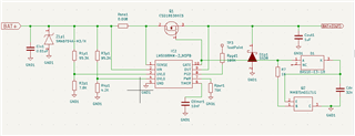

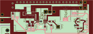

Hello Team,
I was designing LM5069 board and I came across in the document recommending that all the device grounds be connected to each other and then 1 point of  this connection should be connected to system ground.
could you kindly review this ground connection and let me know if this is good?
The highlighted via near the IC is the via connection to ground plane. The highlighted wire and pads are the different component grounds. The green plane is the ground plane
My question is if this would cause ground loops and interfere with the normal operation of the circuit
