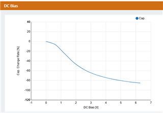

    The capacitance on the output is needed for stability.  The requirement is no less than 0.47uF.  Using a 01005 size capacitor will most likely not provide enough capacitance due to applied voltage bias and tolerance.  To confirm you will want to review the capacitor manufacturer data on the capacitor you are considering.  For example, here is a Yageo capacitor in this package size and value.  The effective capacitance of the capacitor really goes down with applied voltage, without considering of other tolerances, so this would not meet the datasheet spec.

    A 4.7uF, 0201 package size, Murata capacitor is GRM033R60J475ME05D.  Even at 3.3V output this will probably work, however you need to take temperature into consideration as this is an X5R capacitor.

    Thanks for your feedback. I want to confirm with you about the cap, I think our datasheet capacitor value doesn't consider DC bias, since the recommended value is the nominal value. Does my understanding correct?
    If follow the following guide, it will get the 50% effective cap of nominal value, then we could let choose 0.47uF cap, but need to get at least 50% effective cap.

    What the guidance is saying is that the 0.47uF already accounts for the 50% derating.  Section 8.1 does not specify where that 50% comes from, but in practice some of it will come from voltage bias, initial tolerance, environmental conditions, AC ripple voltage, etc.  The absolute minimum effective capacitance is 0.47uF and from my previous review, I do not see a single 01005 capacitor meeting this spec.  They would need to use multiple parallel 01005 capacitors, or something like the 0201 capacitor I suggested if the output voltage is low.
