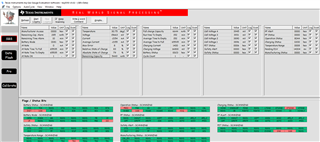

Here is my Battery (4S) Design requirement :
Max. Pack Charge Voltage : 16.4 ( Cell Voltage = 4100mV Max.) , EDV Fix method.
Max. Pack Discharge Voltage : 12.8 ( Cell Voltage = 3200mV max ) after that DSG MOSFET must be OFF to provide  0V pack output.
1. How many Charge / Discharge Cycle Battery BMS needs to learn its full capacity ? considering FIX EDV method.
2. I have Updated EDV and FCC. RESET IT. but even after 2 Times full charge-discharge cycle during charge it Automatically jump from 69% to 100%.  Also, nearby jump we see during discharge as well.
3.  VDQ and CF are already Set , See below snap. As per our understanding Qualified discharge is happening....we are discharging battery using 2A of resistive load. while EDV2 is set @3500mV.
We are not sure , where we are mistaking here....
  • Hi Bhupendra,
    I am currently running this test in the lab to verify the behavior and find a solution. I will get back to you tomorrow with an update.
    Jackson
  • Ok...FYI : All test i am doing with BQ3050EVM -001 board.
  • Attaching Discharge Log data FYR.

  • Thanks Jackson,
    1. Ohh , Now we understand , we are making discharge around  EDV2 threshold @  RSOC = 0% , As per your info we need to discharge it till EDV0.Correct ?
    2. Also , CUV threshold ( In order to make zero voltage less than 12.8V ) must be less than EDV0 threshold , right ?
    3.  In general , How many Charge - Discharge Cycle required to achieve its full capacity ?
  • Hi Bhupendra,
    1. Yes, discharge until EDV0 so that the gauge can learn FullChargeCapacity.
    2. CUV threshold should definitely be under EDV0. EDV0 represents when the cell will report 0% SOC for your application but CUV is a safety parameter just to protect the cell from permanent damage.
    3. It should just take one dsg/chg after a reset.
    I also did some digging on why it may be jumping to 100%. You are probably reaching a Valid Charge Termination where RemCap is automatically set = FCC. This will report 100% SOC. Try to clear the CSYNC bit (this will disable the RemCap update on Valid Charge Termination) and see if this 100% jump still occurs.
    Jackson
  • 1. On full discharge , what are the ideal flags set to look for ? because RSOC = 0 for EDV1 and EDV0.
    2. At present , EDV0 = 3200mV, EDV1 = 3250mV  , EDV2 = 3300mV , CUV = 3190mV, CUV recovery = 3250mv, would that be fine ?
    3. Can we set EDV0=EDV1=EDv2=3200mV  , all same values ?
    4. CSYNC is SET.  Do you want me to make Zero ?
  • 1. EDV1 should force the gauge to 3% not 0% when crossed while discharging.
    2. I would maybe lower CUV recovery threshold to 3150. I am not sure of how the gauge will react when CUV recovery is higher that EDV0. It could work fine but it may be better to avoid any possible headache here.
    3. I would not set these values all the same. you then risk SOC jumps to 0% when discharging and the voltage suddenly hits the EDV threshold.
    4. Yes, please make it zero just for debug purposes to be able to tell if that is what is causing the RSOC jump to 100%.
    Jackson
  • 1. I have changed EDV0 to EDV2 values as above , now jumps reduces 14% to 8% during discharge and from 92% to 100% while charge. Executed 3 complete cycles. Should i still execute more cycle OR Reduce EDV values ?
    CUV Set =3190mV.
    2. Is it okay if we set EDV0..2 voltage threshold difference to 20mV OR Lesser ? what should be the minimum voltage difference required among EDV0 to EDV2 ?

  • Hello Bhupendra,
    I took a look at your log, it looks like you are setting your EDV points while the voltage discharge is still fairly flat, CEDV works best when the EDV points are in the knee of the voltage curve at the end of discharge. It is very hard to tweak the algorithm so there is no jump if the voltage points are above the knee voltage region.
    If you have the CSYNC bit set the gauge will force FCC to RemCap when VCT occurs, this may also be contributing to the RSOC issues at end of discharge as well since extra RemCap is added. You should set your VCT conditions to best match your specific battery and charger so you don't have RSOC jumps to 100%.
    Sincerely,
    Wyatt Keller

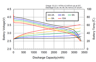

    FYI , Cell discharge characteristic is here:
  • Hello Bhupendra,
    It is up to your system requirements for the gauge accuracy, with continued cycling the accuracy should improve as the gauge learns the battery better. I would say 2% jump is very minimal.
    Sincerely,
    Wyatt Keller
