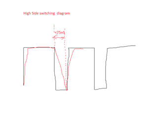

    Eg: If my input is 9.99V and Vout =10V, the calculated D = 0.1%, which means, that the low side switch On time is around 4.03µs and the high side switch-off time is 4.03nS. Whether this condition can achieve? Does it have a limit of minimum DC? if yes, how much it is? When the controller stops switching and bypasses the input as it is a pre-boost? the input range applicable is 8V to 16V.

  • Hello Phil,
    Thank you so much for your testing observation. Can you help me with the following queries?
    1.) May I know what this range from 8.53V to 10.25V is? could you be able to see the switching in this range? eg: You could able to see switching at 9.5V, is my understanding correct? what about less than 8.53V?
    2. Sorry, I didn't understand the observation, Could you explain?
    3. So, my high side switch should be able to switch off time at least 75nS? This implies I should have a MOSFET with a fall time<75nS as my high side drive. Is my understanding correct?

    3. Yes; please refer to the TPS4333xEVM User Guide for the MOSFETs part number. I found the booster switching waveform on the EVM is not very good ; I suggest to use faster MOSFETs.

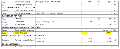

    Thanks again for your detailed explanation. I'm still confused a bit about #1 and #2. In #1 you said <8.53V there is no switching and bypassing the input voltage with some voltage drop. also in #2, the booster stopped switching when VBAT=1.99V. May I know the behaviour in between?
    Also, Any idea, why the booster is not boosting the voltage to less than 8.53V? It's supposed to boost the voltage right?
    Amal
  • Hi Amal,
      The device is designed for power supplied from car's 12V battery; its booster is designed for the battery voltage lower than its normal level caused by its engine starting moment. Please see specs below for VIN 2V to 40V with condition of "Boost controller enabled, after satisfying initial start-up condition".
      So, VBAT>8.53V is the "start-up condition"; the booster stopped switching when VBAT=1.99V is normal specs.
      Please let me know if you have further questions.
    Thanks!
    Phil
