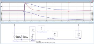

I'm designing a 24V motor driver application and I have some problems by chosing the right input protection. So my application needs to withstand overvoltage events defined by the ISO 7637-2 standard. My idea is to put a TVS Diode at the very beginning of my supply input in order to clamp the overvoltages.

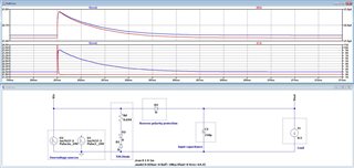

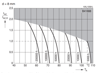

When I simulate the circuit the results show that the bulk capacitor (150µF) is so big that it takes up the whole energy of the overvoltage event. Thus the input voltage does not increase signaficantly and the breakdown voltage of the TVS diode will never be reached (so it is useless). The Problem with that is the high current flowing into the electrolytic capacitor (about 11A). I have the fear that the high current will significantly decrease the life time of the capacitor. Do you have any advice or ideas to deal with that problem?
Without input capacitance
With input capacitance
