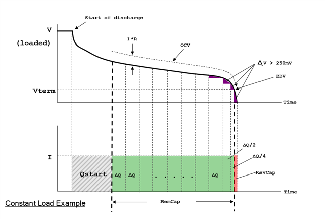

The impedance tracking algorithm is used for simulation. What does it mean when the voltage change is greater than 250mV when it is approaching the cut-off voltage? As shown below.
This is just to show the severity of the voltage drop off when the battery is near fully depleted. As you reach full depth of discharge, the voltage begins to drop much more rapidly in the same amount of time with a constant load.
