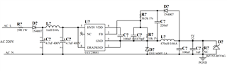

Hi Team
There is a good new that we DIN TI UCC28881 !
Can you check the SCH to see if they need to be modified?
Hi Team
The functional schematic seems correct. You can use the application section in the data sheet and the excel tool or the Webench tool to help setup the design.
These tools can be found at the following link.
