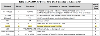

Hi Team,
For a VCC to BOOT short, we state that device damage would occur as shown in Table 4-4 below. This device is being used in a BMS system which has a safety goal for prevention of thermal runaway events. Can we confirm that a VCC to BOOT short has no risk of this?
