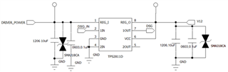

Dear TI experts,
The following is the circuit on our new product, please help to review whether there is any problem with the design, thank you!
Dear TI experts,
Hello Rogers,
The implementation seems fine from what I can see. We often like to look at the output stage (the path from DSG to the FET's gate in this case) so that we can confirm that section is done properly. In any case, the implementation here with the regulator tied to VCC is a normal implementation and all of the bypass capacitors look good.
Lastly, is there any reason in particular you are opting to use this driver? It is quite old, so there is some risk associated with using it in a new product.
Alex M.
