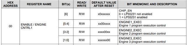

    I notice that you set CNTRL1 register to 0x15, which means you don't enable the chip, you can try to change the value of CNTRL1 to 0x55.

    I will show you the register you need to configure down blow:
    (00) ENABLE/ENGINE CNTRL: enable the device and choose the engine execution mode.
    (01)ENGINE CNTRL2: use this register to Load or Run your program.
    (04/05)OUTPUT ON/OFF: control on/off for D1-D9 output
    (36)INT_CLK_EN: select the clock source, we need 32.7kHZ for correct operation.
    (3A)STATUS/INTERRUPT: configure the interrupt for engines.
    (4C/4D/4E)ENG PROG START ADDR: It is the start address for each engine program.
    (4F)PROG MEM PAGE SELECT: use to select your program memory page, I will show your more details on blow photo.
    (70H/75H) ENG MAPPING: you can read the mapping information from here.
    Please check these registers.

    I notice that you set 01ENGINE CHONTROL2 to 20, which means bit[5:4] is 10.
    I think at first you should set the bits to 01 to load your program, after that, change the bits to 10 to run your program.
    Besides, ENG1 MAPPING is a READ ONLY register, you can only read the situation of each output.
    If you want to configure the engine or select the outputs you need, please use the LED Driver Instructions(Table 4) and LED Mapping Instructions(Table 5).
    If you want to trigger your device ,you can find the trigger instruction in Branch Instructions(Table 6).
    You can also find the description of each instruction in the datasheet.
    Thanks.
