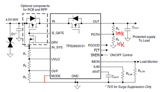

Dear TI Support Team, I have a question about the PGTH function of the TPS26631.
Are there any conditions for when PGOOD goes high at VPGTHR?
When PGOOD is low, does PGOOD go high when VIN = Vout instead of the set voltage by PGTH?

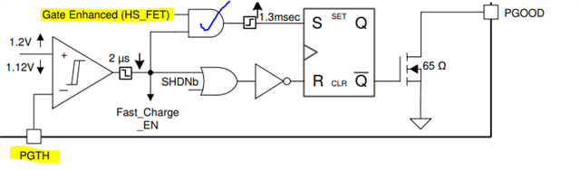

    Rakesh:-  For PGOOD to assert HIGH both internal FET has to be fully enhanced as well as PGTH >1.2V
    Rakesh:- No

    What are the conditions for Gate Enhanced (HS_FET) to go high?
    Watanbe
  • Hi Watanbe,
    GATE has to cross VIN+3V for Gate Enhanced (HS_FET) to go high

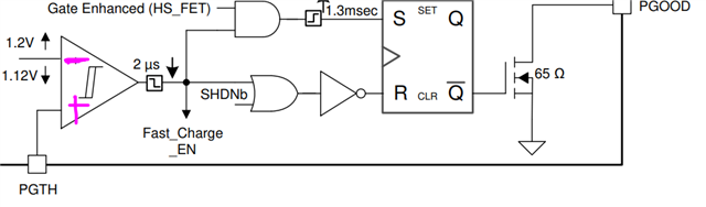

    Please let me know the following three questions.
    (1)Which part of the block diagram does the GATE mentioned above refer to?
    (2)In the above block diagram, when PGTH > 1.2V, the output of the hysteresis comparator for PGTH goes low and PGOOD does not go high?
    (3)When the SHDN terminal is open, is the input terminal R of the RS flip-flop always low?
    As a result of checking our system, PGOOD becomes Low when SHDN=OPEN and PGTH falls below the threshold.
    In the block diagram, it seems that PGOOD will never go low if R is always low, so the behavior does not match.
    Best regards, Watanabe
  • Hi Watanbe,
    1A) GATE of the internal FET
    2A) You are right, the polarity of the PGTH comparator should be reversed.
    3A) We will check on this and get back to you.

  • Thanks Rakesh
    1A) Could you tell me the conditions under which the GATE of the internal FET crosses VIN+3V in the gate control logic?
    2A) What is the mean of your comment"the polarity of the PGTH comparator should be reversed" ?

  • Hi Watanbe,
    1A) when SWEN is HIGH
    2A)
    3A) When SHDNb is Open, it is pulled high internally, then PGTH pin will decide the state of PGOOD output. If PGTH is low, PGOOD Is low and it PGTH is high, PGOOD is high. So, OR gate is correct for SHDNb and PGTH signals.

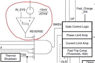

  • Hi Rakesh,
    1A) I think SWEN goes high when Vout reaches Vin (Vin_sys) during startup, but in the block diagram, the output of the comparator is reversed, so it goes high before Vout reaches Vin (Vin_sys). Are my thoughts correct?
    2A) I understood. thank you.
    3A) If SHDN is open and internally pulled up to 2.7V, SHDNb will always be high, so the OR gate output will always be high regardless of the state of PGTH. Is the SHDNb of the OR gate input reversed? Or is the polarity of the comparator that outputs SHDNb reversed?

  • Hi Watanbe,
    1A) It is correct. When IN_SYS is higher that +ve input of comparator, the output of comparator is 0 which then negates before going to AND gate
    2A) OK
    3A) Got what you are saying.. the SHDNb should be a negate. Now, it make sense.

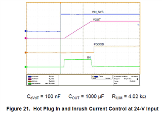

    1A) Is it only in the reverse connection that the above comparator output becomes 1 and is negated before proceeding to the AND gate?
    In that case, I think PGOOD goes high at the same time as Vout starts rising at startup.However, in Figure 21 of the datasheet and in our system, PGOOD is high when Vin = Vout at startup, so I think it doesn't match the block diagram.

  • Hi Watanbe,
    Rakesh-> yes
    Our designer confirmed that the power good block mentioned above is correct. Can you explain step-by-step where it is not matching.

    ・Block diagram operation (normal startup)
    ①SWEN goes high after Vin is input and exceeds PORb and UVLO thresholds.
    ②the GATE of the internal FET crosses VIN+3V in the gate control logic.
    ③At the same time that the FET turns ON and Vout begins to rise (with a delay of 1.3ms), it is set in the RS flip-flop and PGOOD changes from Low to High.

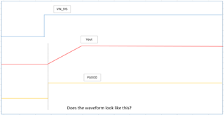

    ・Figure 21 of the datasheet and in our system
    PGOOD goes high after Vout has finished rising
    (At the time of our confirmation, the resistance of the PGTH pin is as follows)
  • During startup in dvdt mode, the GATE is controlled as source follower and GATE of the internal FET doesn't cross VIN+3V until Vout becomes equal to Vin
