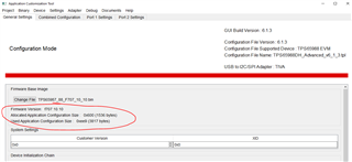

BIN FILES: I tried to save bin file from the GUI, but I got an error: The size of the app config data table generated by this project (0xee9 bytes) is larger than the allocated region supported by the firmware image (0x600 bytes). Save operation has been aborted.

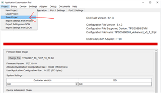

    It seems like there is a bug with exporting the settings as JSON file. This issue is being addressed and will be fixed in the next version of the GUI (version 6.1.4). For now, I recommend saving your configurations as a PJT file instead by clicking on Project->Save Project and then choose the file location and name as shown below:
    You can load a PJT file onto the GUI and you'll be able to access all setting configurations. I will send Vsevolod an example PJT file with your configuration settings copied onto it. If your current project (from your end) shows on the General Settings page the Used Application size is much greater than the Allocated size, you'll need to create a new project (the JSON setting probably corrupted something in your project). Example of corruption is shown below:
    Avoid using JSON settings until the next GUI version is released. If you have any further questions or concerns, please let us know!
