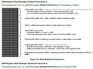

1. I don't have complete information. In any programming spi-protocol,example
SLUAA11A-BQ76952 Software Development Guide.
2.Request an example of spi-protojol programming, writing commands (16-bit)
3.Settings What are the steps sequence ?

  • Hi Ernest,
    This example was created using the Command Sequence window in BQStudio. It just is doing a 1 byte read from 0x9261 (first write to 0x3E the data 0x61 0x92, then read one byte from 0x40 to see the result).
    So here is how you would do this in code:
    TX_Reg[0] = 0x61
    TX_Reg[1] = 0x92
    SPI_WriteReg(0x3E, TX_Reg, 2);
    delayUS(2000);
    SPI_ReadReg(0x40, RX_data, 1);
    Matt
