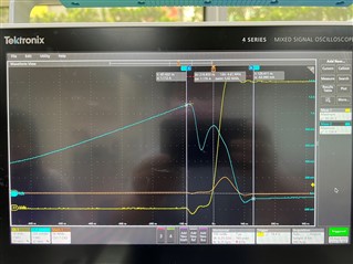

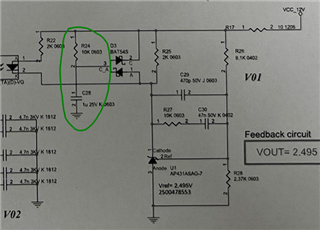

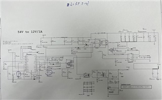

 Would you help to check the schematic and primary FET VDS, current waveform to see any clue for this issue?

    2.Is the 3rd picture the zoomed-in picture of the 2nd one?

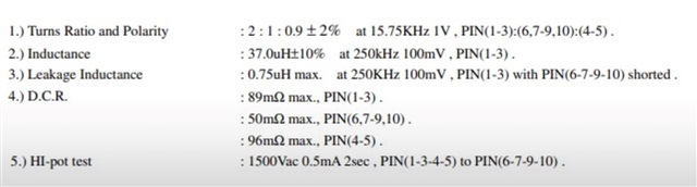

    3.Do you have the datasheet of the flyback transformer in the schematic (UT38363s)?

    2. Yes. It's the zoomed-in waveform.
    3. Please see the below pictures.

    Since the damage happened at the MOFET and the current sensor resistor. I would first think about the rms current and device overheat issue. While, based on the waveform, the rms current seems less than 1A. Considering the 0.063 Ohm on-resistance, the conduction loss is less than 0.07 W. The switching off loss based on the zoom-in picture is about 2.7 mJ (54V * 1A * 0.5 * 100ns, a rough estimation). Assuming a same switching on loss, at 250 kHz, the switching losses is about 1.35 W.  So the total power losses could be ~1.42 W. With a 50 °C/W junction-PCB thermal resistance and a potential PCB-ambient resistance (depends on the pad size, seems this package does not have a thermal back pad). The temperature rise on that MOSFET could be more than 100 °C if the PCB-ambient thermal resistance is high.
    By the way, since you are not suing GAT2, you could short DT to VB to disable the GAT2.

    2. Actually we already short DT to VB, you can see the schematic DT pin with the VB wording on it.

    Thanks for your response. Sorry that I missed the VB label in your schematic.
    The flyback transformer you used has 37 uH mutual inductance, which shows a peak-peak current close to100% of the dc current as shown in your waveform. I think using a flyback transformer with larger mutual inductance (50 - 100 uH probably) could reduce the rms current and switching-off current to potentially lower down the MOSFET power losses.

    1. Gate to source oxide failure: for some reason, if R20 and R21 fail first, then the turn-on source voltage is close to the drain voltage, while the gate voltage is refer the RTN rather than source. So the Vgs voltage could exceed the limitation and breakdown the gate to source oxide.
    2. Drain to source breakdown: for some reason, if the voltage overshoot is higher than the 150-V rated voltage at some operation conditions, the MOSFET may have insulation failure or degradation.
