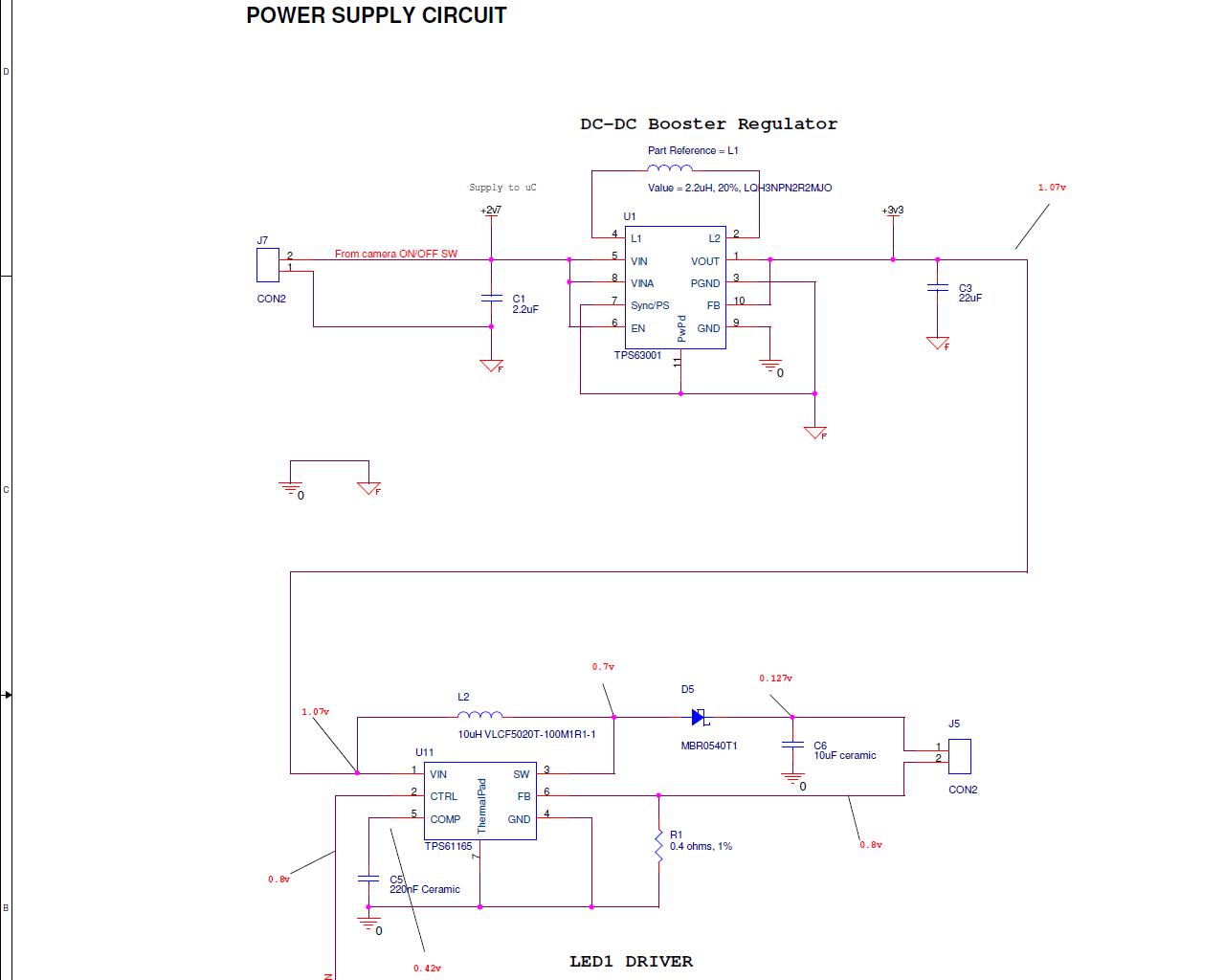

I am having issues with TPS61165 and they are
1. w/o 10uH inductor, TPS63001 booster gives out 3.3v as expected.
2. With 10uH inductor, the booster o/p reduces to 1.07v and not getting expected working from LED driver.
In both the above cases, connecting  the 3W LED at the driver o/p is not helping the cause.
I have marked the voltages at TPS61165 nodes in BOLD RED texts with arrow.
Trying to drive a 3W LED.
Appreciate any help.
Attached is the image of the circuit.
Karthik
  • There are several things that could be wrong, so this will require some debugging on your part.
    First, the TPS63001 requires at least 4.7uF of input capacitance.  I would recommend adding a 22uF input cap and seeing if that helps.
    What is the current limit of your 2.7V input supply?
    Can you try powering the TPS61165 directly from a lab power supply and not through the TPS63001?
    The voltage on CTRL (pin 2) is 0.8V.  This is between the logic high and low levels.  What is this pin connected to?  Can you send a scope capture of what it looks like?
    Yes, you will need to attach the LED for the circuit to work properly.

  • Is the circuit on a custom PCB or are you using two of TI's EVMs?  If a custom PCB, then my question is did you manually solder the TPS61165 and/or its passive and active components onto the PCB?  If so then is very positive that the IC was damaged during soldering.  These 2x2 QFN packages will expand when heated assymetrically (i.e. soldering only one pin) and this can cause either the wire bond or the die itself to crack.  If you do not have access to a heat gun or solder reflow oven, you can attempt to solder the IC and components on a hot plate so that the thermal differential is lower.

  • The TPS61165 has a current limit slightly below 1A.  Being a boost converter, it will never be able to provide output currents near its current limit.  Please use datasheet equation 4 on page 14 to determine how much output current the TPS61165 can provide given your minimum input voltage, maximum output voltage and efficiency estimate of around 90%.

  • The TPS61165 should only be trying to pull current up to its maximum limit of 1.44A.  Can the rail supplying power provide that much?  If not, then it will be pulled down.  If you broke the connection between the TPS63000 and the TPS61165 and tried powering the TPS61165 from a power supply and did not see switching at the SW pin and/or the SW pin rise above the input voltage, then the TPS61165 is damaged.
    Also, I didn't see an input capacitor close to the TPS61165 between VIN and GND on your schematic.  That is recommended.

    We tried hot-air gun soldering and the system worked good.
