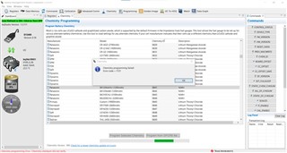

We still need help getting our bq34z1xxEVM working with the Battery Management Studio and our new Ni-MH battery pack.  Normally, the bqStudio automatically detects the gauges in my EVMs.  -not so with the bq34z1xxEVM.  What version of the Studio should we be using?  Do we have the correct *.bqz file?
What exact *.srec file should we be using and how do we load it into the gauge with the programming screen if the bqStudio doesn’t recognize it?
One of my teammates writes:
“When I’m starting the Battery Management Studio and select bq34z100G1 fuel gauge the application warns that the device is not compatible. I have tried both versions available at TI web page (1.3.111.1 and 1.3.101.1) and both say that the device is not compatible. This might be related to the chemistry programming issue.”
-and here’s a screenshot of the error message…
Next, we’re trying to set up to test our new battery pack, consisting of seven Panasonic BK-120AAHU cells in a 7S-1P configuration.  Panasonic shared the following:

My colleague writes:
“I’m trying to use TI Battery Management Studio to program our battery data. I would like to program battery chemistry id 0641. I have updated chemistry data to version 982 for that purpose. When I try to program the chemistry id, I get the following error message: Chemistry programing failed! Error code = 1721. See attached picture.”
Can you help us get our system running?
Carl Olen
  • Hello Carl,
    You should open the gauge manually with the .gg file in BQStudio and then use the SREC file on the product page to program the device. By default the EVMs are shipped with BQ34Z100 firmware, not BQ34Z100-G1 firmware, the BQ34Z100 is not supported in BQStudio until you program the new firmware. That is most likely why you are seeing the error during chemistry ID programming, it maybe memory mapped to the wrong locations, I would not recommend changing or programming anything else until the -G1 SREC is programmed.
