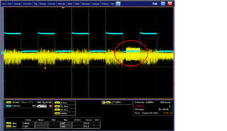

  • Hi Garrett
    TPS650947 SW1 +VNN Test Transient test.
    Blue is the current waveform.
    Yellow is the voltage waveform.
    When the current is light load, the voltage is different from the previous level. Any comments on this?
  • Hi Gareth,
    Upon initial inspection I agree it is odd that the voltage behavior circled in red is different compared to the previous periods with light load current. Is this observation repeatable? Also is the customer using the recommended output capacitance (220 uF) listed on datasheet page 13?
    Looking at the provided waveform even with the observed voltage difference the device maintains Vout according to the load transient regulation spec listed for BUCK1 on page 13 of the datasheet. I have included the spec below for reference.

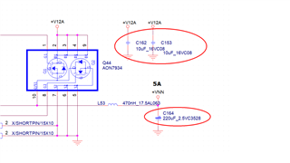

    1.Yes, Vout cap have 220uF/2.5V Pos-cap solution. But at light load, it is often seen that this type of waveform exists.

  • Hi Gareth,
    1)Thank you for confirming the customer has the correct output capacitor. Here are a couple things to note.
    First, the provided Vout waveform appears to have a bit of noise. If possible the customer should measure with a different probe to alleviate the noise and have a cleaner waveform.
    Second, when the load transitions from higher current to light load current the buck regulator switches from PWM mode to PFM mode. In PFM mode the device skips switch pulses to ensure higher efficiency, and will have slightly less voltage regulation accuracy. This may explain why every so often the regulation voltage at light load is slightly different.
    Overall as stated above the difference in Vout is minimal and within the specification for BUCK1 listed on the datasheet.

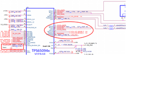

    2) Can you please clarify what you are looking to adjust with BUCK2? From what is shown on the included schematic the connections look to be correct.
