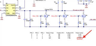

Why did the TI developers configure this board for 22V output instead of 20?
Part Number: USB-C-PD-DUO-EVM
Hi Andrew,
The 22V is to show how the EVM output voltage can vary from 20V. Depending on the connected device, it can go up to 22V or also a little lower than 20V.
