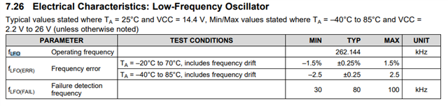

    In respect to my question about the shape of the load current being so very lumpy in the form of very short pulses, what sort of A/D converter is used for measuring the current. and will there be a requirement for us to put in some sort of filtering to average the voltage used for reading the current. Reading the documentation readings seem to only be taken every 250ms, or have I missed something.

  • Hello Bruce,
    You can find this information in the datasheet:
    Also the sampling frequency used by the ADC is in the datasheet as the LFO:
    Sincerely,
    Wyatt Keller
