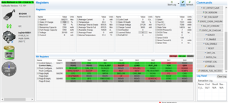

    Since the last time, I followed the steps for learning cycle in TRM guide of BQ34Z100-G1.
    You can find the steps in attached image.
    I discharged my batteries to empty and relaxed them during 5h. After, I enabled IT and Update Status is 0x04. Then, I charged them until the FC bit is High.
    But in steps, when the FC bit is high, the VOK bit is cleared and Update Status is 0x05. For me, the bit VOK bit is cleared but Update Status is still 0x04.
    I have 2 batteries Crystal Batteries 12V -7.2 Ah. Also, I attached the log file for that.
    What can I do?
    Thank you.
     LogGF.log
  • Hello Rayan,
    It looks like the log is discontinuous, this makes it very hard for analysis of root cause issues. We would need to full log and the .gg file from before and after for a full review.
    Sincerely,
