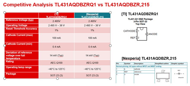

Could you make a device comparative chart of below 2 items?
We are using TI parts TL431AQDBZRQ1, but due to delivery issue, we will escalate customer to approve another maker's device.
TI : TL431AQDBZRQ1
Nexperia : TL431AQDBZR,215
These 2 devices are p2p with very similar specifications. However, TL431AQDBZRQ1, is Q100 qualified.
Hope that helps.
Thanks.
You are correct. I will check to see if there is a comparison chart. But as mentioned specs are very similar so the chart may not be very helpful here.
Here is a comparison chart between the TI and Nexperia parts.
