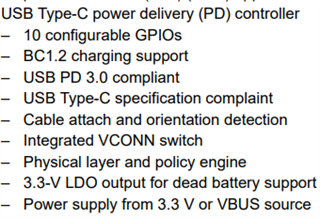

    I do have a question regrading the TPS25750 capability.  I would like to know:
    1.  Does the TPS25750 support the PD 3.0 PPS APDO configuration as a PD sink?
    2.  If it does, how does the TPS25750 negotiate the new adjusted sink voltage or current within a programmed APDO in run time?  Does the hardware need a MCU to assist in the run time negotiation with the PPS capable PD Source if the TPS25750 can't negotiate on its own?
    Thank you,
    -Hang
  • Hi Hang,
    Let me check with my team regarding PPS PD sink for the TPS25750. I'll get back to you by next Wednesday!
    Thanks and Regards,
    Raymond Lin
  • Hi Hang,
    Unfortunately TPS25750 does not support PPS, the support features are shown below:
    Thanks and Regards,
    Raymond Lin
