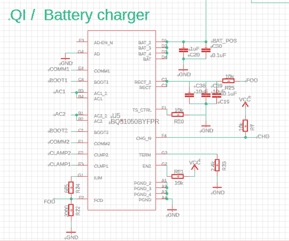

I am trying to use the BQ51050B to charge a small battery (450mAh) with the Amazon basic charger link as described bellow :

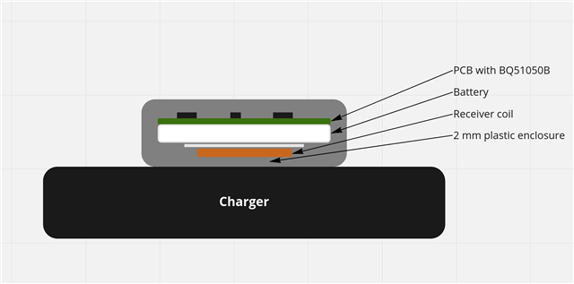

The circuit seems to work just as intended when the battery is not in place, but as soon as I put the battery, the behavior become erratic (sometimes it charges, sometimes it doesn't, sometimes the charger indicates END_OF_CHARGE). I'm guessing, this is because of the metal within in the battery that the BQ detects and tries not to overheat by stopping the charge.
I was thinking to add a layer of ferrite sheet, such as link, in between the coil and battery. Do you know if I can expect a more stable behavior with this addition ?
Also, as I'm working with relatively small Ibulk (400mA), do you know if the FOD calibration can help ?
Thank you
Benjamin

    Yes adding the shielding material is a good first step, Wurth material will work.  AC field from the TX is probably entering the battery and appearing as a Foreign Object, could trip fault or heat up battery.
    FOD calibration would possibly help, what value resistors are you using for R-FOD and R-os, can you send schematic?

    Thank you for your answer. As you advised I've ordered a ferrite sheet, hopping it will solve my issue.
    Concerning the R-FOD and the R-OS resistance,  I've set them respectively to 200Ω and 10kΩ.
    The used circuit is as described :

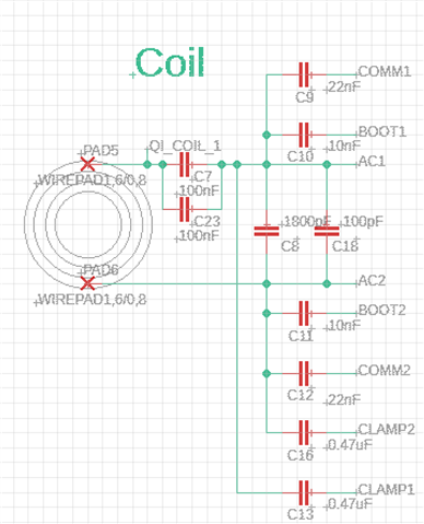

    To meet the desired charging current, we only changed C7/C23 and C8/C18 that correspond to C1 and C2 in the datasheet to 95nF and 992pF.

  • Hello Benjamin
    Couple of things:
    1.) R-FOD is 200 ohm, that is OK but 225 would give more margin.
    2.) R-os is 10k, this is a little low may want to try 20k.
    3.) Coil tuning C1 value is 200nF, this would work for about a 15uH coil.  Which coil are you using .

    Thank you for your answer. Concerning the mentioned points :
    1) Ok, I'll try with a 225Ω if the ferrite sheet does not mitigate my issue. Would 250/300/350 give me more margin if the 225 is not enough ?
    2) Thank for the information. I couldn't find any information about R-os selection in the datasheet. Could you point where I could find some ?
    3) As I mentioned, we changed C1 for 95nF and C2 for 992pF. We are using a 27uH coil, with L' measured around 26.4uH when all the parts are together.

  • Hi Benjamin
    1) "Would 250/300/350 give me more margin if the 225 is not enough ?" -- Bill J - 225 would be enough.
    2) "I couldn't find any information about R-os selection in the datasheet. Could you point where I could find some ?" -- Bill J - This info is in the FOD Calibration procedure see below link.
    https://www.ti.com/lit/zip/sluc577
    3) "As I mentioned, we changed C1 for 95nF and C2 for 992pF. We are using a 27uH coil, with L' measured around 26.4uH when all the parts are together. " -- Bill J -- This would be good.
  • Hello Bill,
    I just received the ferrite sheet and it seems that is enough to fix my issues. I think I'll stick to this solution for now.I'll keep the information you gave me in case I stumble across a similar issue.
    Best regards
