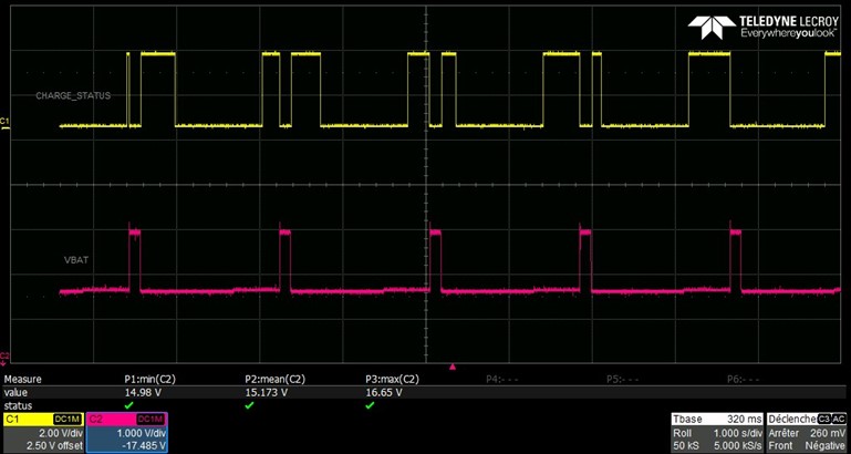

This is what I get on CHARGE_STATUS :
Yellow : CHARGE_STATUS
Red : VBAT
It is like my BQ24600 tries to recharge the battery, but then stop doing it.
Any help will be appreciated.
I can bring you more scopes if needed.

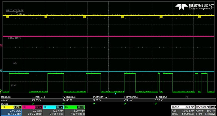

    Can you please include a waveform of the input voltage, Q44A gate, PG, and STAT?

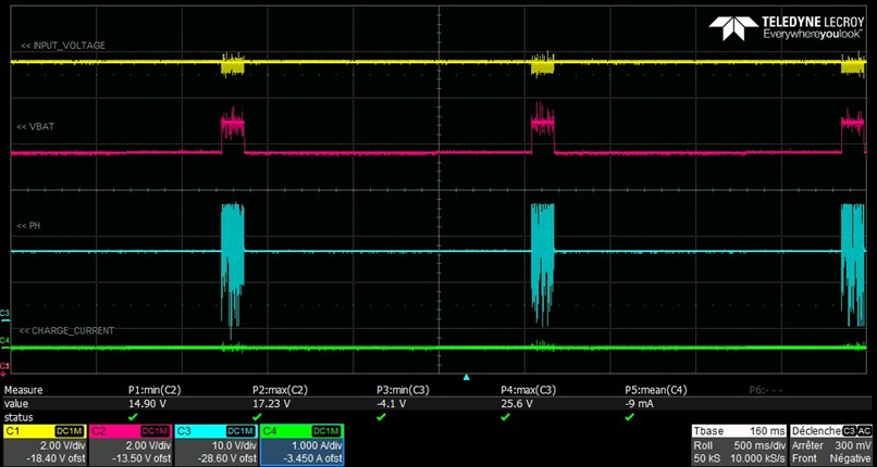

    In addition, can you please include a waveform of the input voltage, battery voltage, PH voltage, and charge current?

    Please find below the waveforms of the Input Voltage, Q44A Gate, PG/ and STAT :
    C1 - Yellow- : Input Voltage
    C2 - Red - : Q44A Gate
    C3 - Blue - : PG/
    C4 - Green- : STAT
    Please find below the waveforms of the Input Voltage, Battery Voltage, PH Voltage and Charge Current :
    C2 - Red - : VBAT
    C3 - Blue - : PH
    C4 - Green- : Charge Current
    As we can see, there is no current charge at all
    However, the blue signal is adding some noise on the others signals.

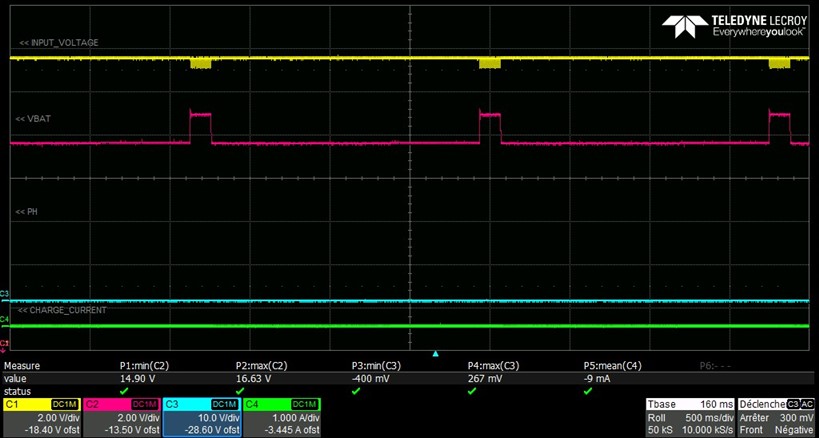

    On the following scope, I retired the blue signal :

    1. If VFB is 2.1 V, charge is complete. The regulation voltage for the VFB pin is 2.1 V. Have you double checked your regulation point? What is your applied battery voltage and what is your designed charge voltage regulation? You state that max voltage is 16.4 V setting, but one waveform shows a max of 17.23 V.
    2. The STAT pin only blinks at 0.5 Hz for "charge suspend, timer fault, input overvoltage, battery absent." Charge suspend relates to the TS pin. Has your charge timer expired? I do not see you exceeding 28 V on the input. You confirmed you have a battery attached?
    3. The input signal looks clean, always connected.

    1. For the battery voltage, refer to the Figure 3 because I have some noise on the Figure 2. As you can see, VbatMAX = 16.63V because of the little spike when the voltage is rising. When stable, Vbat = 16.41V.
    However, the optimal recharge voltage for the RRC battery is 16.8V. So I tried others couples of resistors to be around 16.8V, but it did not solve my problem.
    I am waiting for +/-0.1% resistors to resume my tests.
    2. I confirm I have a battery attached. Otherwise I would have 0V on Vbat when the BQ24600 is not trying to recharge the battery -see Figure 2 and 3-. What is the charge timer?
