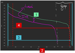

hi. i used BQ4050-R3.
i made Golden Sample. it has problem.
Gas Gauging State Qmax Cell 1 15404 mAh
Gas Gauging State Qmax Cell 2 15361 mAh
Qmax Cell1 is 15040 , Cell 2 15361 mAh. but FCC is 9669mAh.
Why is this happening??
    How were Qmax Cell 1 and Qmax Cell 2 values obtained? Was a learning cycle performed?
    Jose Couso
  • If you look at Lstatus, the Qmax value has been updated to a value of 0x14. The learning cycle was executed.
  • Hello Choi,
    If FCC is much less than Qmax, I can think of two things:
    1- cell resistance might be too high
    2- load is very high
    Also, by definition FCC is the usable capacity of the battery from full to empty, and Qmax is the total chemical capacity (this is not fully reachable, FCC will always be less than Qmax). Please see below
    Legend:
    3- represents Qmax
    1- Open Circuit Voltage
    4- FCC with no load
    As it can be seen above with no load, FCC is smaller than Qmax. Once we have a load FCC is even smaller.
    What might have happened is in the last discharge, the gauge had a big load and FCC was updated accordingly. Also, charge termination will also affect FCC, say the user stops charging at a lower voltage, now the user will get less capacity.
    FCC is established before discharge starts and is based on a simulation from full to empty for a specific temperature and anticipated load.
