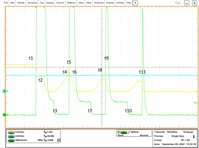

TPS61378-Q1: Hicup timer behavior when OC event is removed during short protection
Part Number: TPS61378-Q1
Hello Expert,
I'm customer is designing circuit using this IC.
Then, they want to know about the behavior of hicup timer when OC event is removed during short protection.
Does hicup timer's count is cleared immediately to 0ms if OC event is removed during 1.8ms short protection timing?
I'm looking forward to hearing back from you.
Thank you and best regards,
Kazuki Kuramochi
  • Hi Kazuki,
    Nice to see you again.
    let me explain with a short-open picture.
    CH1 Yellow Vout  CH2 blue Vin  CH4 green Iout
    t1,t5,t9,t11 are the output short points
    t2,t4,t6,t8 are the points Vin=Vo
    t3,t7,t10 are points that short disappear
    It can be seen:
    at t2,Vin=Vo, the time count start to accumulate, at t3 the short disappear, but the count will still accumulate.
    during t3 to t4,the output start to ramp up ,and the current is limited, and count is still accumulating.
    at t4,Vin=Vo, the time count is about 1.6ms, not enough to trig shut down. then the count is cleared at t4.
    the count accumulates from t6 to t8 ,and still not enough to trig shut down. the count is cleared at t8
    from t9 to t11 the time is enough and no time point Vin=Vo(actually Vin<Vo) ,so the shut down is trigged.
    To sum up, just as the datasheet says:
    If the output current causes the low-side FET to reach current limit and pull the output voltage below the input voltage, the device enters into short circuit protection mode, triggering the hiccup timer.
    Hope it solves your problem.
    Best Regards
    Fergus
  • Hi Fergus,
    Thank you for your kindly explanation.
    I understand that short circuit protection hicup-timer require to exceed Vout to Vin clearing timer.
    Please let me know, if there is miss understanding.
    Kazuki Kuramochi
  • Hi Kazuki,
    You understand it right.
    Best Regards
    Fergus
